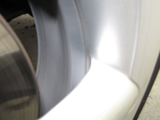

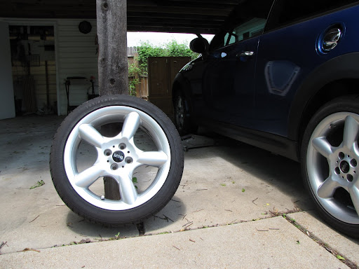

Pics from yesterday; Before After Simple Green After Wheel Armor All done My high tech wheel wash station:lol: Mark
