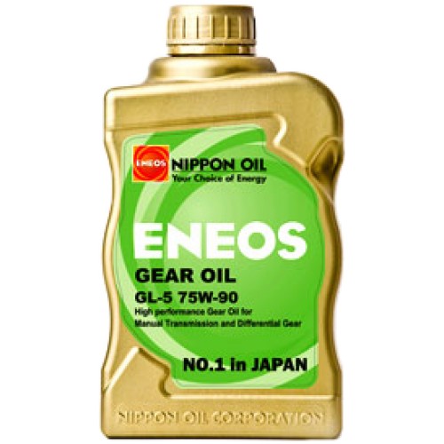

  16. Dave.0

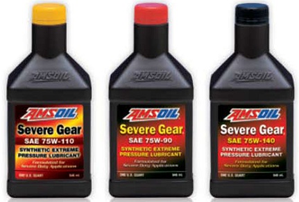

  18. Dave.0
  19. Dave.0
    This is also very good.
