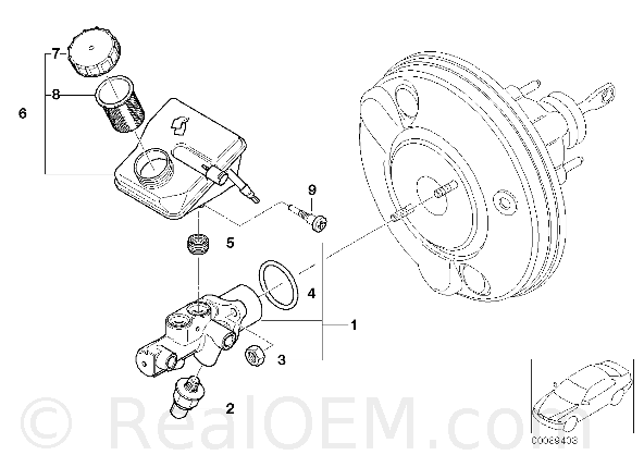

    I'll call Centric to check about the gaskets. O-rings are readily available from realoem, as are the nylon nuts, but I'm not sure about the friggin' gaskets...

    Gasket: part #5
    O-ring: part #4
    Nuts: part #3
