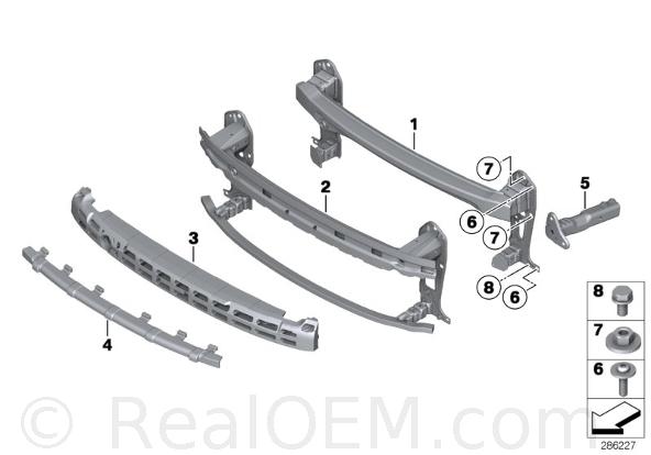

    That section isn't even on the earlier year MINI's..... That lower bumper reinforcement #2 was added probably for added impact resistance... It's about a $300 part if you get new.... Not that big a deal to remove the bumper.... I can do it now in about an hour.... As you can see it's missing on #1
    It just boils down as to whether it bothers you and if you want to spend $300.00.....
    Check out the condition of both #5's as these are designed to collapse on impact..... depending on how hard the hit was...

    This is quite helpful but where did you find the schematic so I can get part numbers?
    Where's the #5 located? Is that a member (that holds some of the bumper frame and is between the car chassis and the bumper?
    I think I may have checked that section and it didn't seem damaged as far as I could tell.
    It's not very clear as to what is welded from what's bolted. it does seem that #2 is one whole welded piece.

    Real OEM Here..... RealOEM.com Online BMW Parts Catalog
    Parts can be obtained from many of our good Forum vendors....
    It's all welded up as a single unit... If you look closely you will see bolt holes.... Go to #1... Same part without the curved bottom bar... and you will see the fastener #'s 6,7,& 8, which are called out on the side of the picture...
    "Where's the #5 located? Is that a member (that holds some of the bumper frame and is between the car chassis and the bumper?" YES

    So weird It's the first place I looked on and couldn't find it in the list. It's probably located in a different section from the other body part section for what ever reason... or I din't realize there are multiple pages which I don't think there is. I look again :Thumbsup:

    hA! found it. It's under the trim section rather than the bodywork. Not obvious :wink:

    If you plug your VIN in the Realoem it will list the parts specific to your mini. Then save it to your bookmarks.... Then whenever you open Realoem, it will take you to your items...:D
    Another trick... You can punch in the part number and it will list where that part is used on other vehicles.... Many times it's also used on a BMW.... So if a BMW parts department is more convenient to you than a long drive to a MINI dealership.... You win...:D
