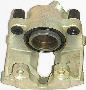

Floating Caliper:
![[IMG]](https://www.2carpros.com/how_does_it_work/images/brake_caliper_floating.jpg)
The caliper "floats" on the two pins. There are one or more pistons only on one side of the caliper. The vast majority of cars came with this type of caliper, including MINIs.

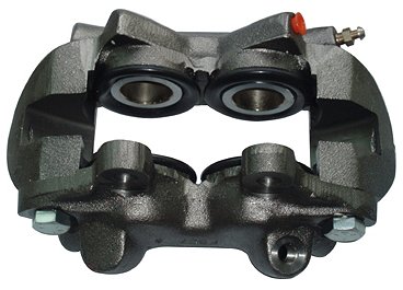

Fixed Caliper:
![[IMG]](https://www.2carpros.com/how_does_it_work/images/brake_caliper_fixed.jpg)
A fixed caliper has one or more pistons on both sides. More expensive to produce and more common in aftermarket and race applications.
