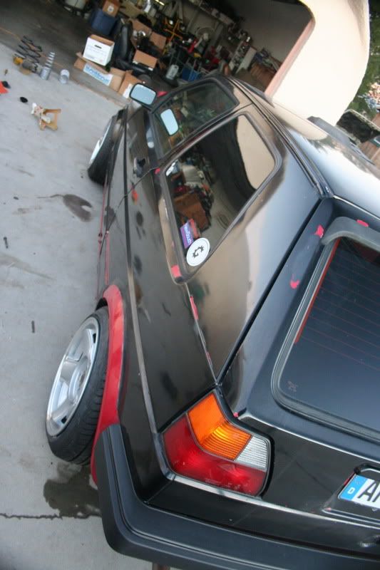

    Finally I have an update worth posting about. I got my wheels and tires on:
    Here is my 17 year-old son that now works here. He is learning the tricks of the trade
    Schmidt one piece Modern-Lines
    Front= 16X9 et25 w/ Falken Ziex ZE-512 215/40ZR-16 XL 86W
    Rear= 16X9 et30 and 17mm spacers w/ Falken Ziex ZE-512 215/40ZR-16 XL 86W

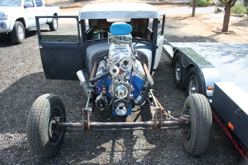

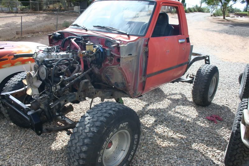

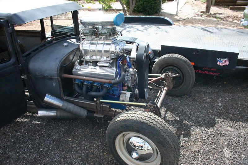

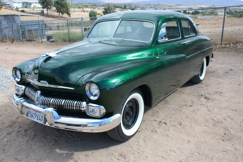

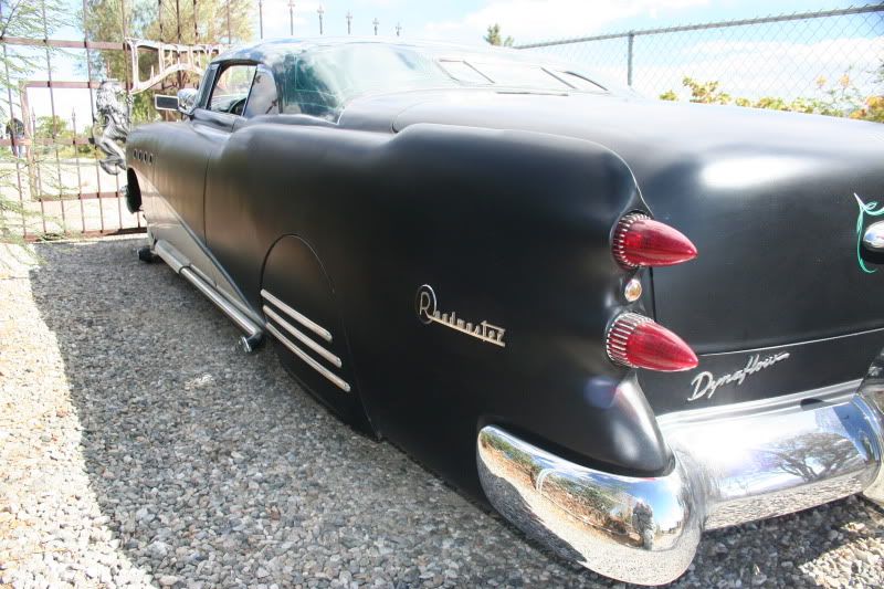

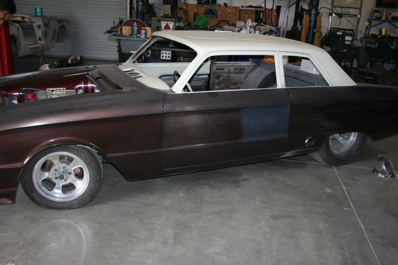

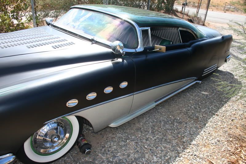

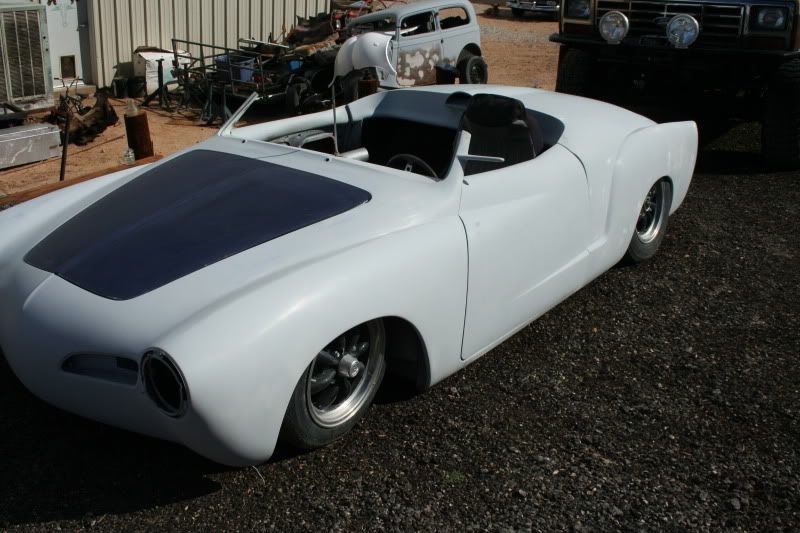

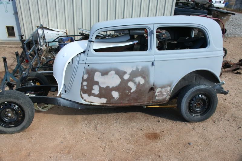

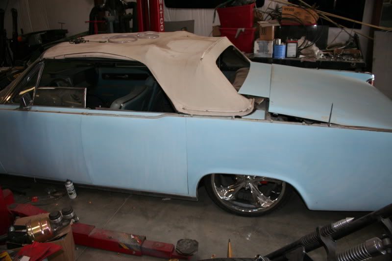

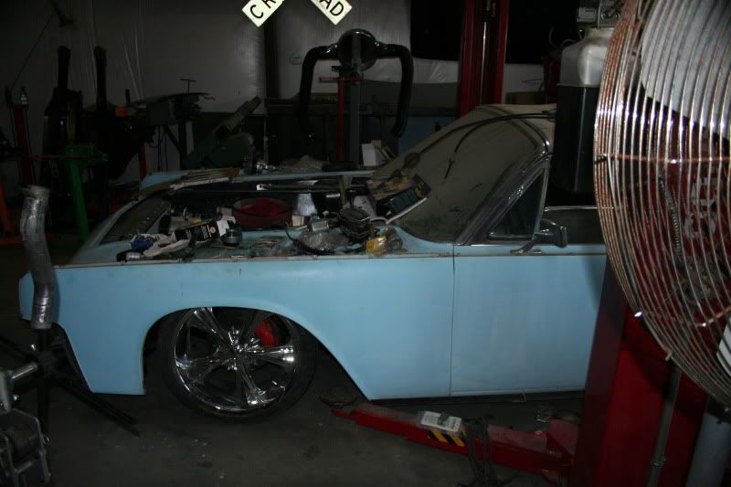

    The arches will stay metal and will be rolled out to fit the wider wheels. In order to explain the lack of progress, I took some pics of what is happening at the shop to show some of the other works in progress. It will show that the car is in good hands and I figured you guys would enjoy some of these:
    Here's a couple of Rhodesian Ridgebacks hanging out
    Corvette Stringray Restoration

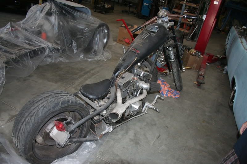

    Custom Bike next to the Corvette chassis

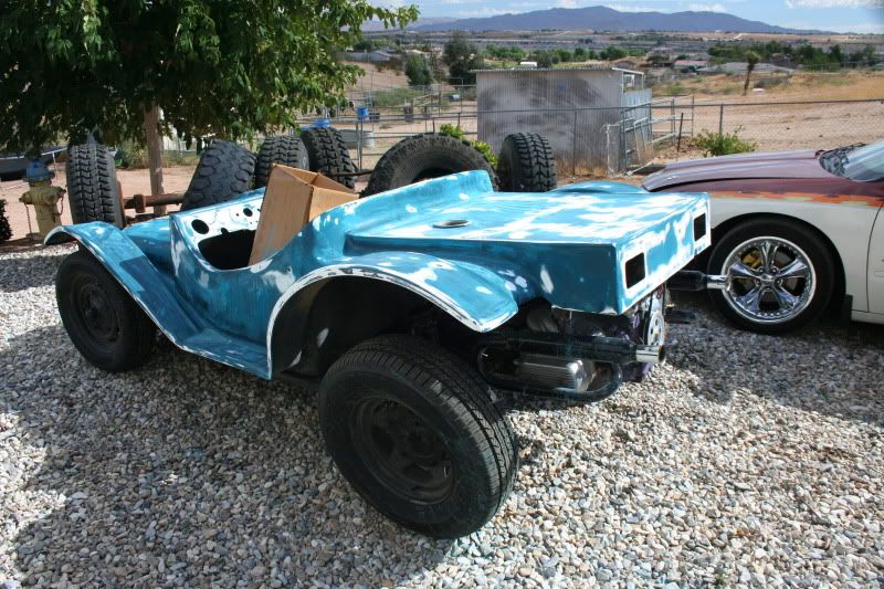

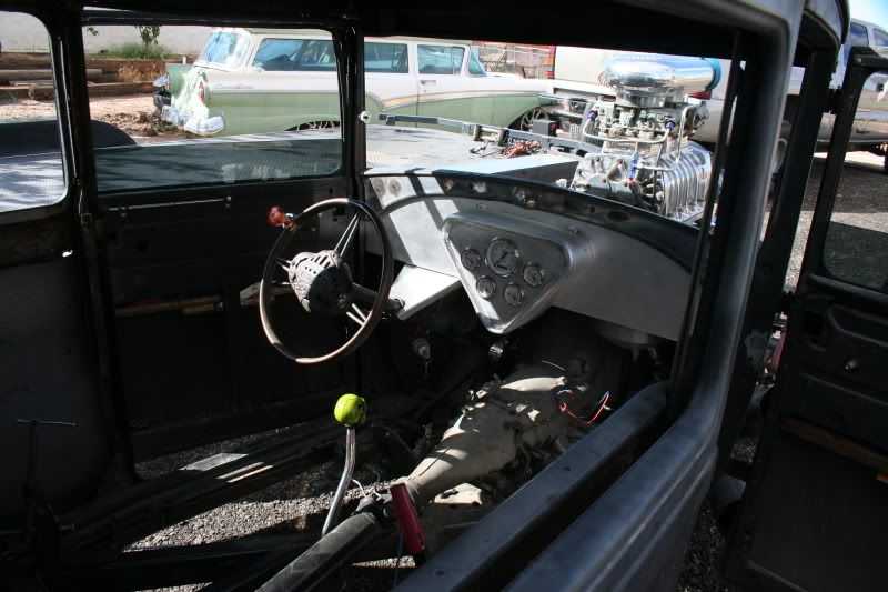

    Falcon street rod
    Suicide Lincoln on bags

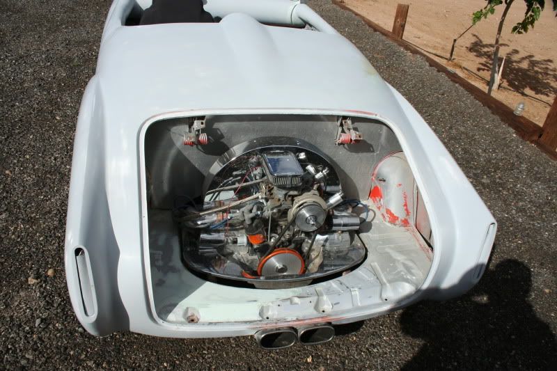

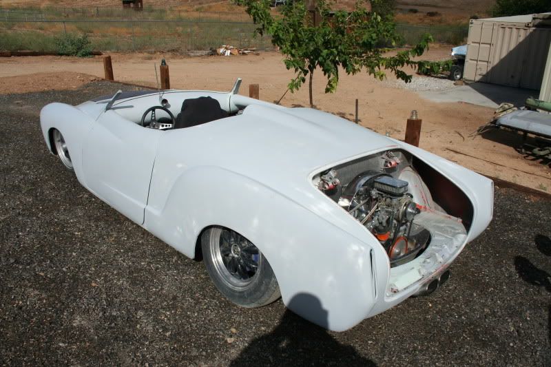

    Bagged Ghia
    30's Roadster

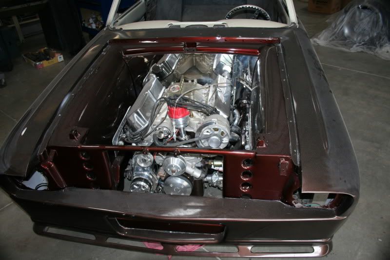

    He runs the radiator in the back of the car to eliminate it from the front
    As I was leaving, one of his finished projects pulled up:

    Looks like they do a wide variety of custom work.....
    I think I've seen that green Merc before on the HAMB or the JJ forum....

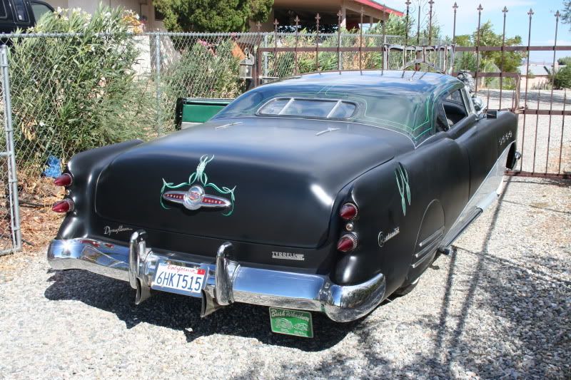

    Not a big fan of the chop on the Buick tho.....
    Glad to see you're getting her going again, but when a shop is busy like this....well I hope your project doesn't get lost in the middle.

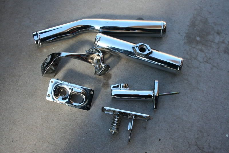

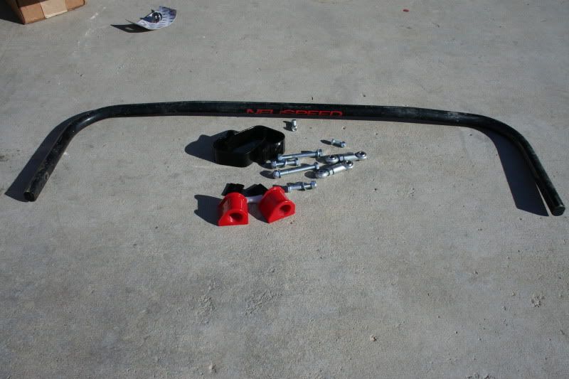

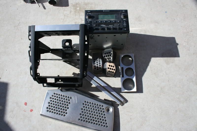

    It finally stopped raining here so I was able to get out and do some long overdue work on the car. New Chrome:

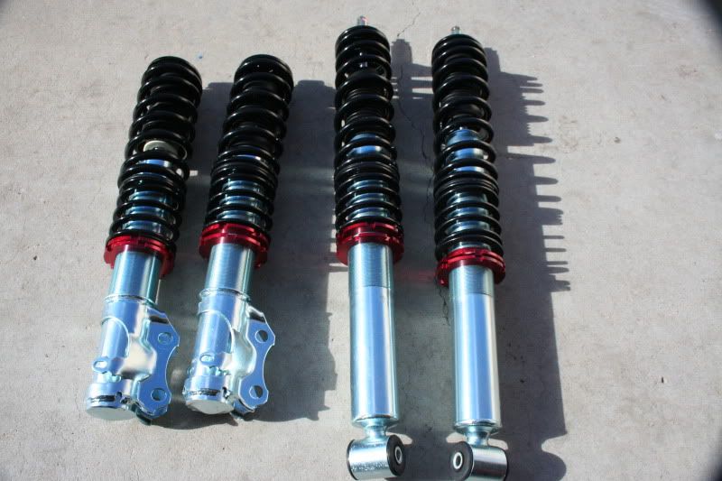

    New Coils:
    20th AE Interior Bits:
    Used Neuspeed Rear Sway bar w/ new hardware:

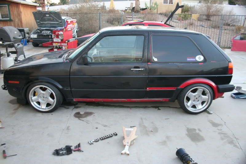

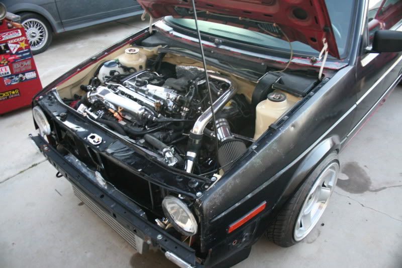

    I got the new chrome pieces installed and put the hood on. I then knocked out the coils and sway bar.
    Coils on:
    Hood back on:

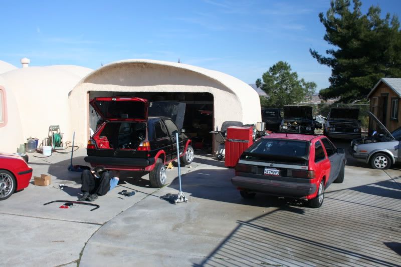

    My wife took this shot while I was underneath the car today:
    All we are missing is my kids 87 Jetta that was parked in the front yard
