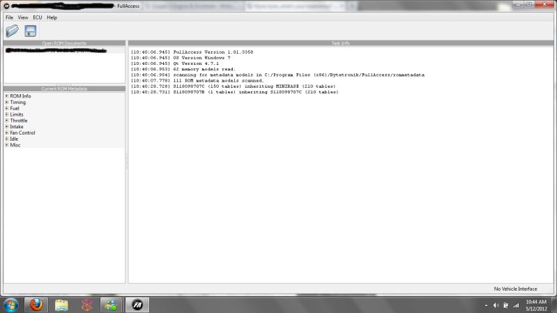

    Its simple, because you are paying $700 for something that is advertised as a full access when its not even close to it. I have some some screen shots showing how its not even close.
    This is F/A

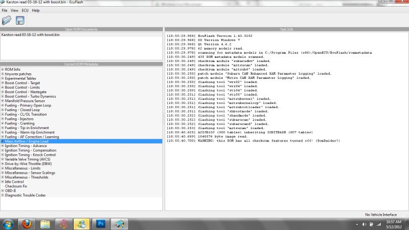

    This is my EVO screen shot with a stock ECU using ECUFlash. Same program. This is full access.

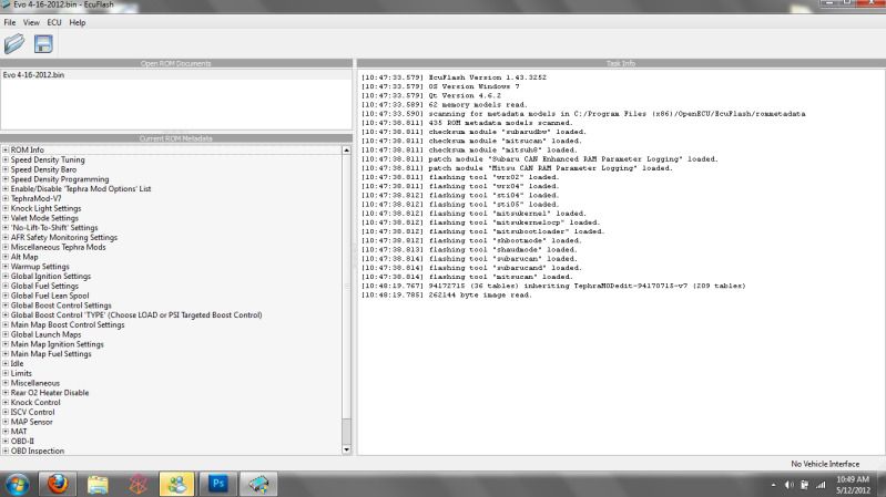

    This is a 2003 WRX on the same program. Full access once again.

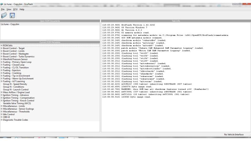

    This is a 2005 STi, again full access.

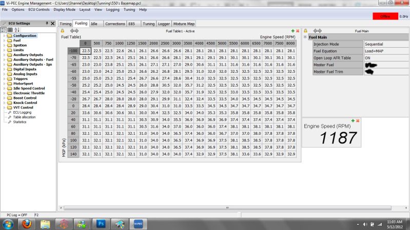

    This is what the ViPEC looks like. Not cheap, but best thing out there if you don't want your stock ECU tuned.
    Thats just to show you that for $700 you really are getting ripped off. Those maps reference other maps that you can't change, or even see. Then you have names on the maps that don't exactly tell you what they do...So you make one change in that map, it goes to the other map and references it and now your changes aren't like you thought they were going to be....So really you don't even have full control of what is going on in the ECU.

    Why the black line through the first and not the others?

    Has the person's name in it, was to lazy to go change it and retake the screen shot so I just blacked it out. The blacking on the ViPEC map is fuel settings that I worked on getting right for a basemap for people with 550's thats why its blacked out.

    Well for one thing my screen doesn't look like the one you displayed. Mine fills up the whole left hand column just as the others you show. I use the software, it works for me and that's really all I care about. You guys give them more advertising then they give themselves, that's pretty funny. People will use what works for them and if it works, like I said that's all that really matters.
    Let's just agree to disagree and leave it at that.

    Thats because you have all your stuff expanded. Every screen shot that I took, MINI, EVO, STi, WRX all had everything collapsed. So yes if I expanded it, it would fill the left side up, if I expanded everything in the other roms it would give you a lot to scroll, A LOT more then you would have in the F/A stuff....
    It works for you that's fine. You still over paid. Can you turn off CEL's with it? How about making it run in OL when you want, like at idle for bigger cams? How about if you want to run a new MAP sensor can you edit any of the tables to run it? Can you change dwell times? Able to change knock table's for lets say a loud motor, or a knock sensor that has been moved to a sprintrex? Like I said you over paid. Im glad you like it and it works for you. You once again still over paid for something that is more like 1/10th access.

    If you want to do a comparison do it accurately, the Vipec & F/A are like apples & oranges, if you want to compare the Vipec to something then compare it to other stand alone devices, and of course for right now it's the hands down winner.
    Then compare the F/A to other "factory ecu" options that are available for "the Mini", so the choices are basiclly 3:

    I didn't even metion the Vipec I showed a screen shot but didn't say anything about it. He asked about a Mynes tune. What do you think they use to tooon? I posted a screenshot of F/a
