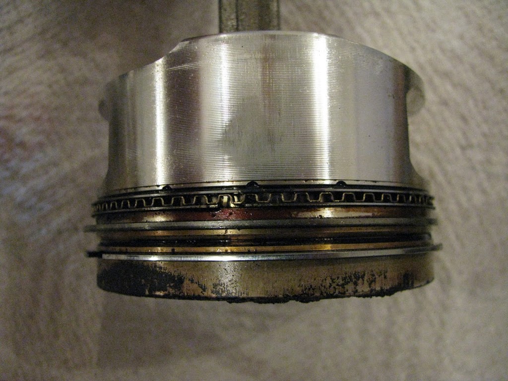

  11. Camaro
    Camaro New Member
    112
    Industrial designer
    +8 / 0 / -0
    Piston #3

  13. agranger
    2,190
    Yeouch! That looks like a pancake that has been on the griddle way too long!

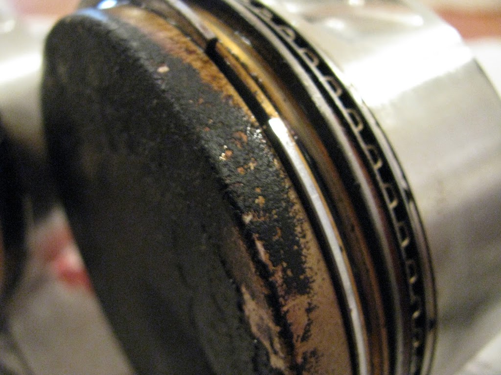

  14. Camaro
    Camaro New Member
    112
    Industrial designer
    +8 / 0 / -0
    So for those who think this had nothing to do with the tune? They have a track record for this. Here is a pic of my #1 piston when the pistons were OEM and after 5,000 miles on Mynes Tune.
  15. mini_racer
    mini_racer Well-Known Member
    1,046
    57
    Engr Manager
    Austin, TX
    +57 / 0 / -0
    Wow, this is Nasty!
    This engine needs a 'real' expert with a proven track record, not just somebody who 'plays' one on the internet !!!
