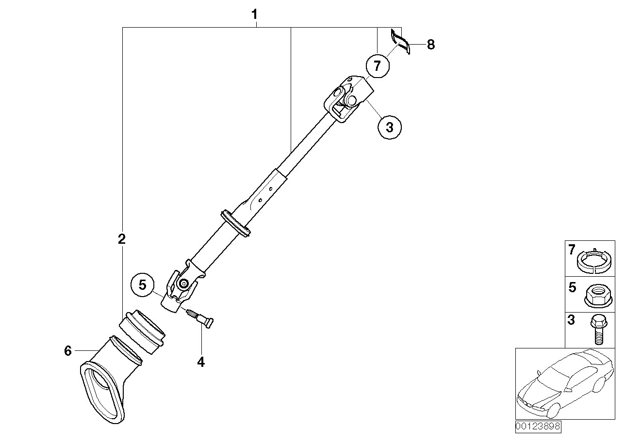

    Thanks for the tip guys. How do I go about repairing the steering column?
  9. Savvy
    Get your hands on a Bentley manual.
  10. melvinyip
    melvinyip New Member
    Apr 26, 2015
    19
    Btw the sound is very audible outside. I've read some articles regarding steering column but I don't think that's my issue here
  11. BlimeyCabrio
    There's only a few things it can be... Steering U-joint, Strut top mounts (replaced already), control arm bushings, ball joints (loose or worn out), tie rod ball joint. Unlikely, but loose wheel or bad wheel bearing in extreme cases. Maybe a bad driveshaft CV joint or right driveshaft support bearing (bad or loose).
    Control arm bushings, ball joints, Steering column seem most likely.

  15. mrntd
    From the video it sounded like it was inside the car. So would have said the same with the column.
    Maybe record it with the camera outside under the car?
