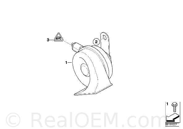

    Aw carp.... I had push on spade connectors in my mind. The MINI has a molded waterproof connector, sorry. That's why Steve cut his off.
    Decision time here, you can go the route of the wire taps that cut through the insulation (which by the way I hate). Or go the complicated route and try to find a matching male and female OEM connector off of RealOEM and make your own "Y" splice. Or do what Steve did and add the splitter connector from McMaster Carr.
    You might see if the OEM horn plug can be snapped open (sometimes they can be for easy damage replacement), if it can, you might be able to make a solder connection inside the plug. This would also preserve your wiring.

    I'm going to see about getting one of those plugs, as I don't particularly want to cut my wires either. Then I'll try and locate the mate. If I'm successful, a simple jumper can be made. It turns out my 09 uses the same horn plug.

    Hey Erika, stopped by the dealer and picked up some replacement horn plugs. They do come apart, so now I just need to determine the best way to make a jumper. Dealer charged me $3.00 each plug.
