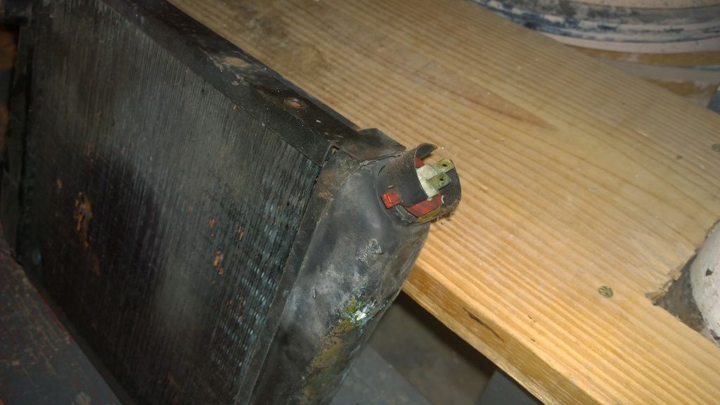

    Argh! Found it - there's this connector on my old radiator, that obviously is the sensor switch for the temp-controlled electric fan:
    As my new radiator lacks this sensor, I guess I'll have to rig up a cabin switch to drive the fan via relay, instead. thanks guys - sorry for the un-needed thread.

    If only the pictures could be a little bigger............:D
    You can buy a sensor that attaches to the radiator core so you can retain the auto function - it simply attaches to the core with some plastic thru ties.....plus you can wire a switch in as an auxiliary too.
    This one is adjustable for on/off temps....

    Thanks very much for the switch link, but I think I prefer to just manually control it - I've seen some others who have done so and always planned to do it at some point... now I no longer have any excuse. I plan to delete the relay currently in the automated circuit and replace it with a manually-controlled one with a cabin switch.
