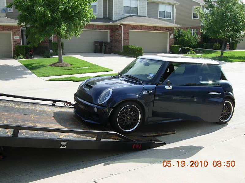

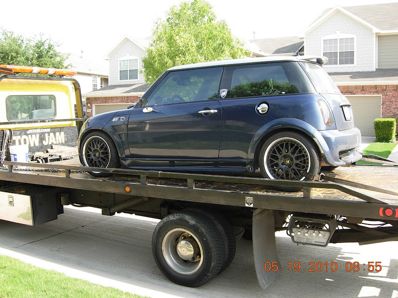

  13. Nathan
    This is becoming a little to common of a sight for me...
    Yes...this tow hook really does work as a toe hook.
    See ya soon...
    Next step is to run to MINI of Dallas to pick up parts..
    Head Gasket
    Intake Gasket
    Oil Pan Gasket
    Spark Plug Tube
    Already have Exhaust Gaskets on the shelf here thanks to PGT.
    And lastly the new piston assemblies arrived yesterday. Thank you again to the very generous person that sent them.
    Will update this thread with progress and pictures of the damage.
  14. TGS91
    TGS91 New Member
    May 8, 2009
    1,593
    Sales Dude
    St. Louis, MO
    +18 / 0 / -0
    Like the name of the tow co...."tow jam"
    Sorry for your troubles but as you have obeserved and Paul has so succinctly put it "you gotta pay to play'
