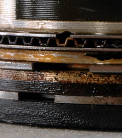

    The cause of the low compression in Cyl was found. The ring gaps all lined up again. This is the second time this has happened. The first time the cyl was honed, the piston re-ringed and it ran fine 25K or so miles. Note that the first instance of this issue was at about 25K miles as well. I will have pictures of this next week.

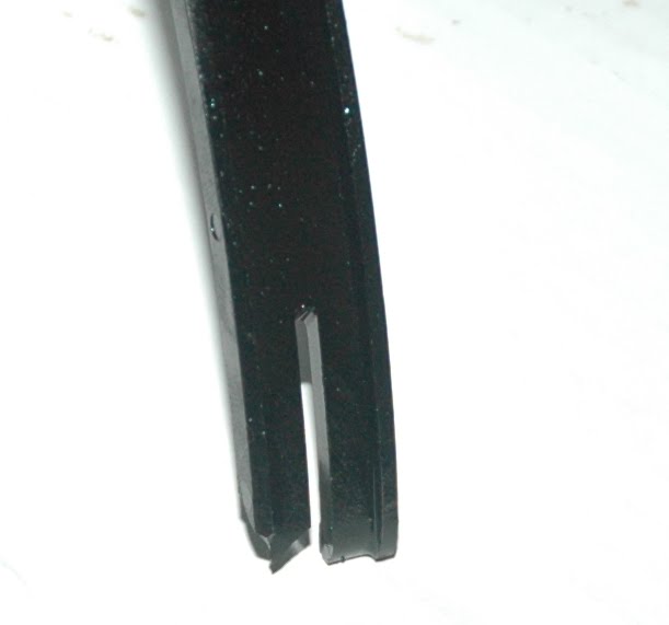

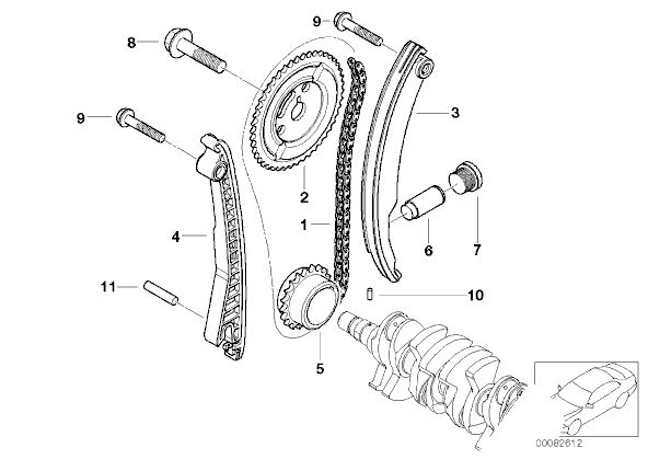

    Chain Tensioner - A chunk of the plastic has broken off. Wayward chunk was found in the oil pan. Replacing the part. Item # 3 in the image below.
    And the affected part. Chunk is missing from left side.

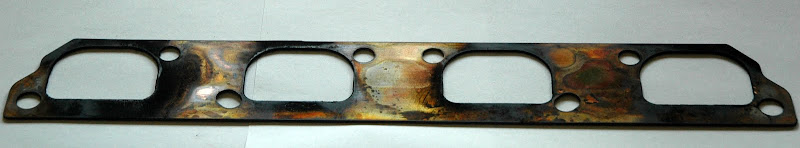

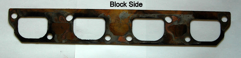

    Exhaust Gasket - The copper exhaust gasket leaks. To be replaced with a crush-able type gasket that PGT had made.

    Thinking about this? You are saying the top two ring gaps lined up correct not the 3rd which is the oil controller? If that is the case then your bore/hone may be incorrect? Piston rings (mostly the 1st and 2 nd ring) will rotate in the bores and settle in a similar location if the the bore/hone is not correct. In theory??
    I have never seen this happen but I called a friend who still has his performance engine shop and he claims to have seen this a couple times but says it was the installers improper end gap measurements and gap position in the bore.
    #43 Nathan, May 21, 2010

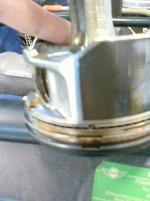

    Called the tech and asked him to send me a picture. This is off a phone. Will get better ones when I go back over there.
    Have a better image of the piston rings now.
    The plan is to measure to bore to make sure it is round. I did take a lamp to take a good look at the hone marks and all the cross hatch marks are nice and even around the entire cylinder. I'm starting to think the piston may be slightly deformed.
    A bit more detail of the area.

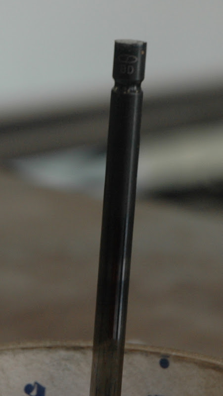

    Twas going well...till this...
    Now mind you, I did blow up the photo and enhance the colors to make it easier to see.
    The stem ain't that dandy looking either...
    The coating is worn, they tell me this could be an issue with the valve guides too...oh goody.
    That one is the worst of the 3 obviously damaged exhaust valve. The head is off to the machine shop for a full tear down and inspection.
