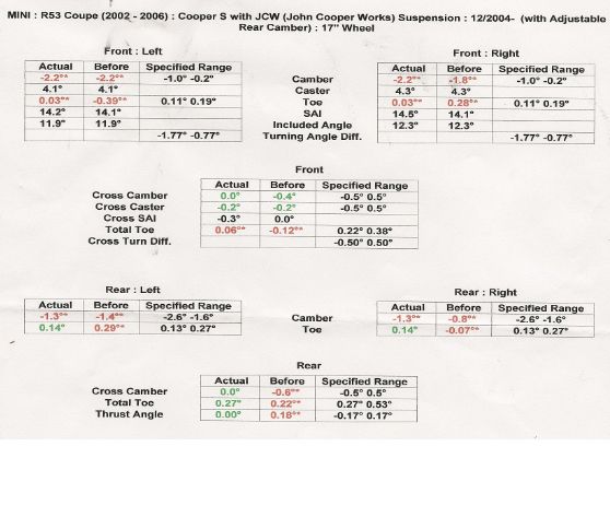

    Get the anti-sway bar before the Dragon and then take your car to a good shop and say set you car up like this. (See below) :Thumbsup:
    These are the specs from my car and it has been set up like this every Spring for the past 5 years or so. My friend Menda and a few others all run this spec setup all year long. :Thumbsup:
