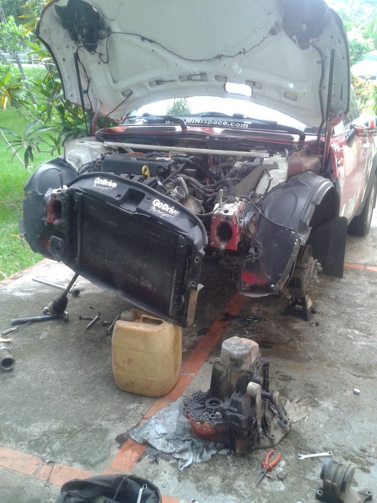

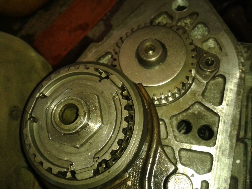

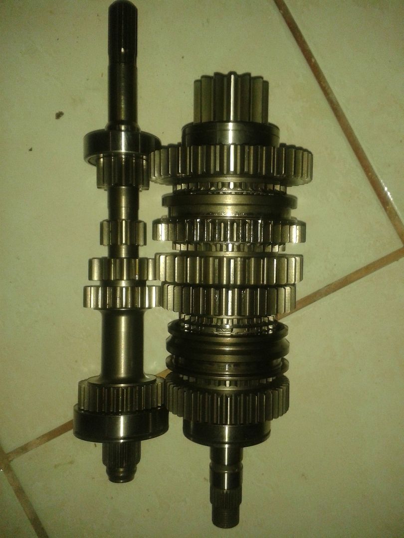

    Finally something interesting to write about! I was a little nervous about this build as I was not sure if the Peugeot gear set would work in the Midlands casing and selector forks. Friday night I carefully built up the gear set from a donor Mini gear set. What was interesting was the oil ways were completely blocked with oil sludge. It pays to swap the life time oil!
    Saturday I got up at 6am and by 7:15 the box was out, then 45 minutes later the box apart! Seeing as I had to split the LSD to fit the new crown wheel I decided to inspect the internals. All the plates looked good so I rebuilt the LSD with the 4:2 final drive. Then I had the swap all the parts over from bad casing to the good one.
    You can see the 2 tubes of gasket goo that didn’t stop the oil leaking out. Dropping in the gear set was routine as before. The only issue was the Peugeot input shaft has a C clip and not a nut. Unfortunately I did not have a washer to fit under the C clip. Lucky for me I found a washer the correct size. Phew!
    As always putting the box back in takes longer but I was surprised the box mated to the engine with the first try! I fitted a new ball joint and radiator while I was at it. The radiator swap is easy as now I have the fan attached to the plastic surround. It did not help that most of the day it rained, the joys of working outside. Plus I bitten by the all the bugs flying around.
    By around 4pm I was ready for the test drive, I was super excited because I’ve never had a straight cut gear set. I was wise to use a synchro set up instead of a dog engagement as shifting is like a normal box.
    Once I got on the street I shift through the gears expecting a loud whine but was surprised to hear only a slight whine, 3rd was pretty loud so I should imagine from outside the whine could be heard. The spread of ratios was really nice making the weedy Cooper engine seem more powerful. This morning I was able to open up on the side road to work confirming the 90mph in 5th at 6000rpm …sweet! So there you have the first Midlands with a straight cut gear set. I hope it will last without regular rebuilds.

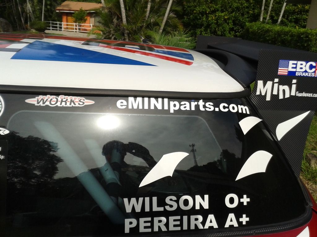

  19. eMINIparts
    eMINIparts Well-Known Member
    Mar 13, 2012
    3,751
    1,087
    MINI Parts Advisor
    Bedford NH
    +1,090 / 0 / -0
    Looks Awesome.......Can't wait to see pictures from the Winner's podium....:cornut:
  20. Nathan
    Chris, M/A stickers are on the way!
    Thanks for supporting M/A on the Rally Car.
