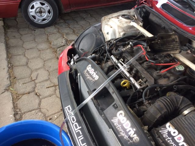

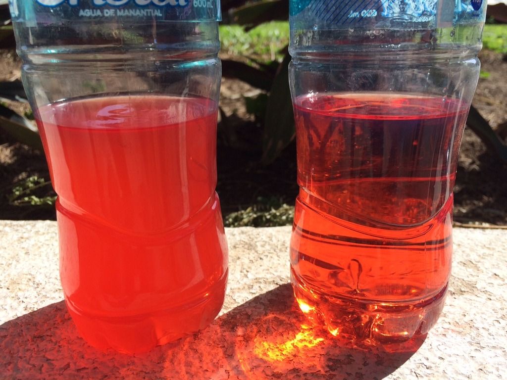

    The weekends fun photos ..The bad fuel is on the left.
  9. RallyMini370
    hahaha actually they ran out of jet fuel once at the airport so all the planes had to fly to Panama to refuel.
    I was thinking the other day that I had reached a limit of things to do on the Mini...now I'm fully engaged on finding out why it won't run...LOL

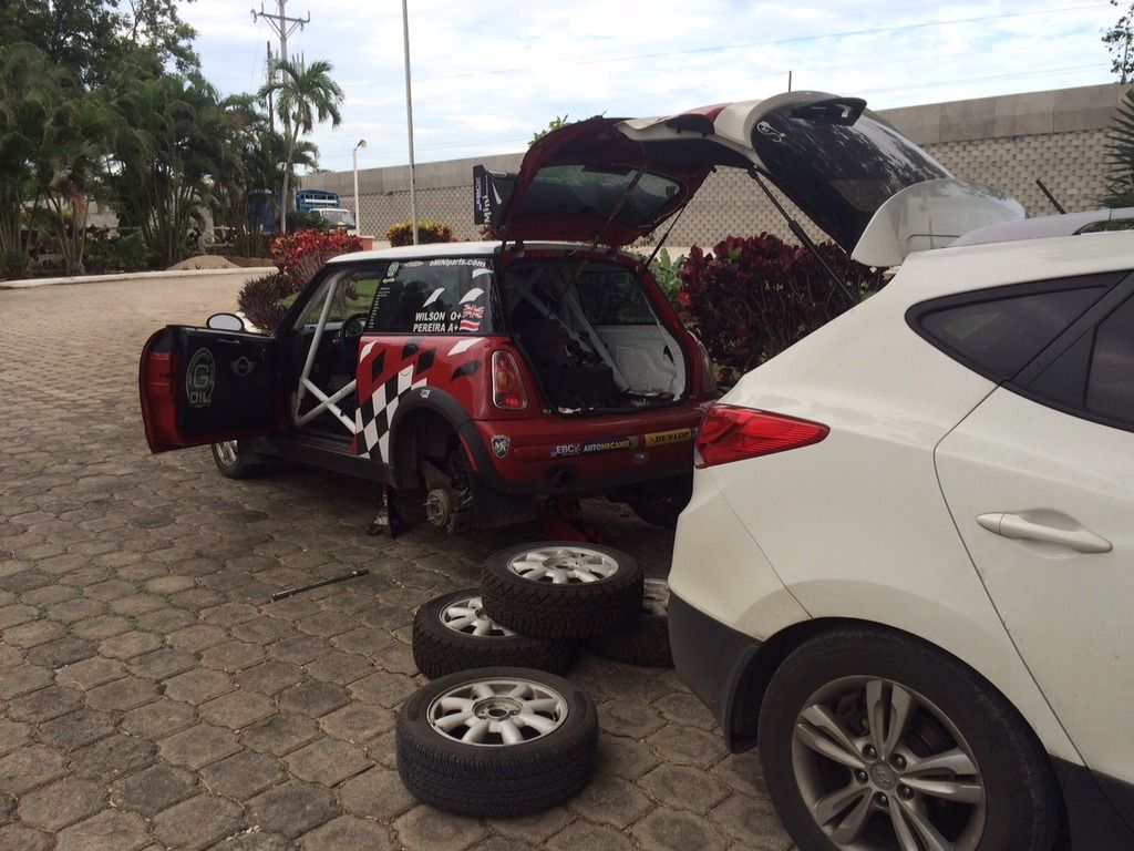

    I got into Costa Rica a day early so I could have an extra day to work on the Mini. The good thing having the Suzuki rally car is I can recycle parts from it. I used the tank guard and mud flaps to make the rear under body protection. The rear damper mount is just waiting to be hit by a rock so I made a bracket to mount 1/8” mud flap material. Hopefully that should help save the delicate rear suspension.
