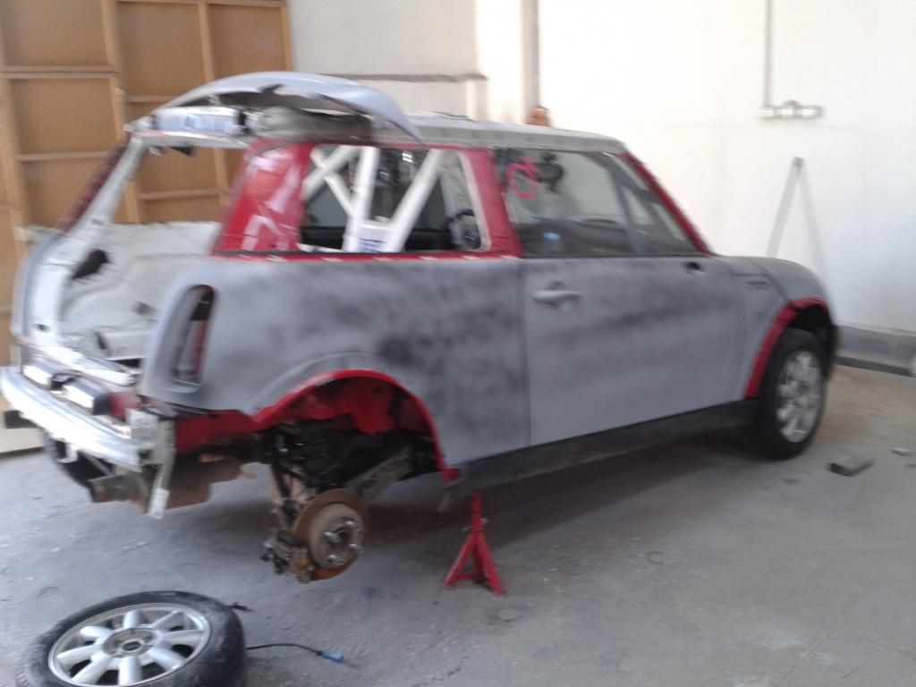

    After 3 weeks of buying parts on Ebay (thanks to MA members) and Eminiparts for the dealer stuff I finally got to see the Mini at the weekend. Apart from some body filler on the left rear panel the mini was pretty much as I left it 3 weeks ago! Thank goodness the rally was canceled. The weekend was really hot after arriving from a chilly MA so I was sweating buckets working inside the large paint shop. First job was to repair the hole in the plastic fuel tank which I learnt form Youtube! Even the body shop guy seemed impressed that I filled the hole with nothing more than a soldering iron! Then I started on the right side rear suspension. This took most of Saturday until about 5pm as the shop was not a place I need to be when it got dark. Sunday I arrived early and finished off the suspension and brakes for the right rear. Lucky I used aluminium lateral/trailing arms as they sheared off causing no chassis damage.
    Seeing as the brake fluid was gone I took this opportunity to replace the 130,000mile brake/clutch master cylinder. The brake MC was easy but the clutch MC was very difficult to remove and replace. Once I had that done I bleed the brakes and left the clutch for next weekend. Also I cleaned out the interior of broken glass and mud and tried to organize the various screws and bolts laying around after the body shop guys had removed the trim etc. I know there guys are doing me a favour working on the car but their working practices and mine are so different. I bag and label stuff whereas they just throw the stuff in a pile on the floor which most likely works for them.

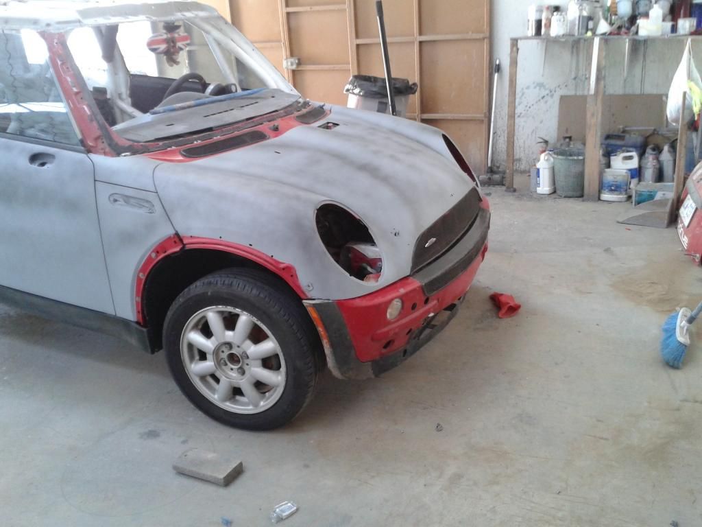

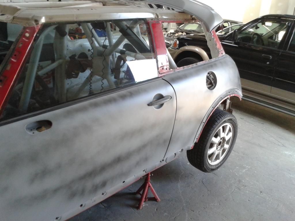

    It's been a busy week at work so being Friday I thought I'd up date you good folks. The Mini mechanical wise is back as it was but the body work and ordering the parts from Mini CR is painfully slow. We still don't have a roof and the parts took 6 weeks to arrive only to find they didn't send the RS rear window! The other frustrating thing is I've ordered parts based on what the body shop needs only to find they have some of the parts and need other parts I didn't order...no one said this was going to be easy! Currently the Mini looks like Modfather's rat rod!
