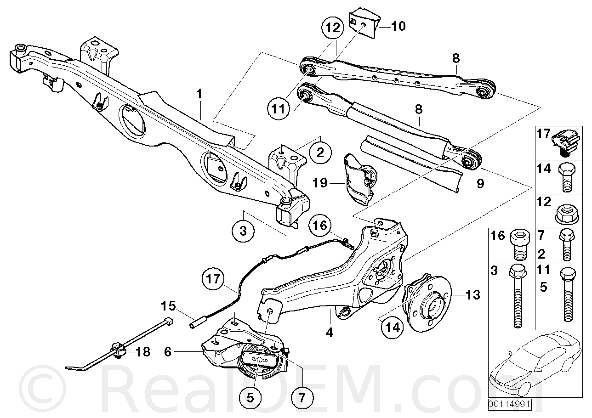

    How do I adjust rear toe? I want zero toe.

    The rear toe is adjusted by sliding the Trailing Arm in sloted holes. There are three bolts that are loosened, the arm moved, and the bolts tightened. There is a special BMW tool for doing the adjustment but it can be done by trial and error without the tool. Measure, loosen, adjust, tighten, measure, and repeat.
    Many alignment shops will not adjust the rear toe because they say it requires a special tool. The alignment shop that I go to does it without the tool but said it was a pain in the butt the first time the tech did the rear toe adjustment (took him about an hour but I have a GP which makes it harder to access the bolts). When the bolts are tightened the toe tends to change a little making it a little guess at where to adjust before tightening. After doing the rear toe a few time, the tech is much faster.
    If you install aftermarket adjustable rear control arms, the toe can be adjusted using the control arms instead of the trailing arm bolts.

    The upper arms can adjust the toe, the lower will adjust camber.

    Bracket #6 is where the toe is adjusted, if it isn't obvious to all those interested in this....

    Even if one does have adjustable control arms, I feel that adjusting with the slotted holes on the trailing arm bracket is still the right way to do it, as opposed to changing the length of the control arms. I find that it helps to trace the outline of the bracket onto the body with a paint marker before making an adjustment; then you can see how far you have moved the bracket, and it makes it easy to find your original setting just in case things get really screwed up.

    If the rear control arms are used to adjust toe, they must be lengthened or shortened top & bottom together, and that affects the distance between tires. The range of motion for the trailing arm within its bushing will be reduced if track is altered drastically; the early model bushing/arm is slightly more forgiving than the later model, BTW. For this reason I recommend setting the upper arm to stock length if it is aftermarket adjustable, and don't mess with it. Either the top or bottom control arm can be used to adjust camber, they are not designated top for toe, bottom for camber; the lower arm is just easier to access.
    Only move the trailing arm bushing bracket to adjust toe.
