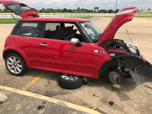

    THE DRIVE HOME:
    I found the car on-line and after talking to the owner, having an independent inspection done by a mechanic and checking CarFax, I pulled the trigger and traded in some frequent flyer miles to get myself from Charlotte, NC (my home) to Austin, TX where the car was. I flew out on a Friday evening, got a good night's sleep in Austin and Uber'd my way to the owner's home. I gave everything a good once-over, signed the papers and handed over the check... away we go! It was great to be back in an R53 again and my first drive was short... a nearby drug store for snacks/drinks and an auto parts store for some basic hand tools, a compressor, Slime tire repair and some new front wiper blades (the old ones had turned up as bad on the inspection report and it was right). I got on the road, heading up to Dallas to have lunch w/ a friend and then to begin the long haul on I-20 through Arkansas, Mississippi, Louisiana and Alabama.

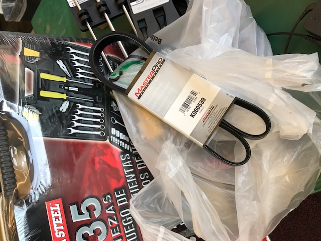

    Around 10pm on Saturday night I was 40 miles or so from my first planned stop for the night. As I was about to cross into Mississippi from Louisiana, I noticed the AC go warm/humid. Uh oh... I know R53s, so I immediately looked down to see the CEL on and the thermostat climbing quickly. Crap! Luckily I was right at an exit, so I ducked off the highway and into a decently lit parking lot (the only parking lot in the middle of nowhere) that belonged to an off-track betting shop that was still open. At least there were people around and I had cell service! I called to cancel my hotel and booked a new one in Vicksburg, MS, about 10 miles away. They gave me the name of a cab company owner (Roosevelt, who owned the 2-3 car operation) who came out to get me around 10:30pm that night and got me to the hotel. While I was waiting, I popped the bonnet and found the serpentine belt with a complete break... Oh well. I had stopped before all of the coolant had cooked out, at least, so I was lucky there!
    I woke up early on Sunday morning and got looking into things. I found a cluster of auto parts shops a few miles away that opened around 8-9am, so I walked to an ATM (cash is king when you are stranded), had a big breakfast at a Waffle House and hiked my way to the auto parts shops to be there at 8am when a few of them opened. I can tell you that even at 7:30am, walking in the 99% humidity of Louisiana in August isn't fun. Luckily, the first parts store I went into had a JCW belt on the shelves! I bought the belt, some coolant, a tool set in a blow-molded case and the largest pry-bar they had in-stock... of course I don't have the tensioner pulley tool yet, so I'm going to have to become innovative.
    Roosevelt picked me up and took me and my assorted purchases to the car and I settled in for a long morning. It took a few hours, but I was finally able to get the belt tensioner locked back so I could get the new belt on. I give each pulley a twist (praying that the stock crank pulley isn't the problem) and find that the idler pulley bearing is seized. Ugh! I went into the AC of the OTB shop and started making calls. The third shop I call has the part on the shelf!!! How I found parts for a 12 year old MINI in rural Mississippi on a Sunday morning, I have no idea! Some deity must have been looking out for me! I bought the pulley on-line for in-store delivery and called Roosevelt one more time. He picked up the part and drove it out to me while I got everything put away and ready to go.
    About 15 minutes after he dropped off the pulley, I had everything back together and the car was running like a top. Unfortunately, that was about 1pm on Sunday afternoon, so I had lost 1/2 a day of drive time. :( Luckily, my hotel felt bad for me w/ my car broken down, so they gave me a super, super late check out... I was able to grab a quick shower after the several hours of rolling around in the dusty parking lot before getting back on my way home.
    I had hoped to be home Sunday evening, but that wasn't going to happen. I made it to the north side of Atlanta when I gave out and decided to pull over for the night. I finished up the last 200 miles early the next morning and was to work by 10:30am!

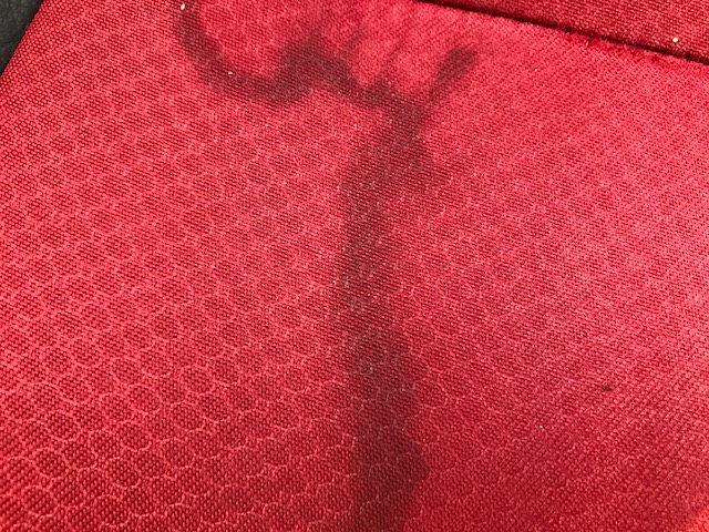

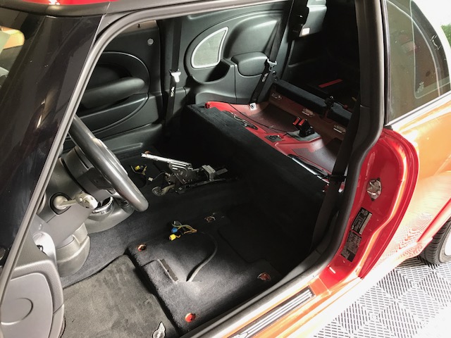

    Interior Cleaning:
    Ugh... the interior of Rufus is pretty dirty. The previous owner took it to a local detailer a day or so before I picked him up (very nice of him!), to see if they could clean up the inside and I can see that they tried, but I don't know if the red fabric seats can be salvaged. If they tried really hard and this is as far as they got, it doesn't look good.
    I bought a gallon of upholstry cleaner from the Chemical Guys and took the interior apart. The front seats came out, as did the e-brake console and the rear seats (thanks YouTube... I never would have figured out how those rear seats came out without some video help). I ran a test spot w/ a carpet cleaner and the upholstry cleaner and got some good results:
    The right side is where I cleaned things up. The left is the 'before' photo and that big black stain in the middle is where capillary action carried grease and dirt away from the cleaned area. It looks like the cleaning will work out!
    I'm about 1/2 way through the interior bits now... completed all of the black carpeting, the rear boot carpet and the rear seat floor... front seats and other bits as the week progresses.

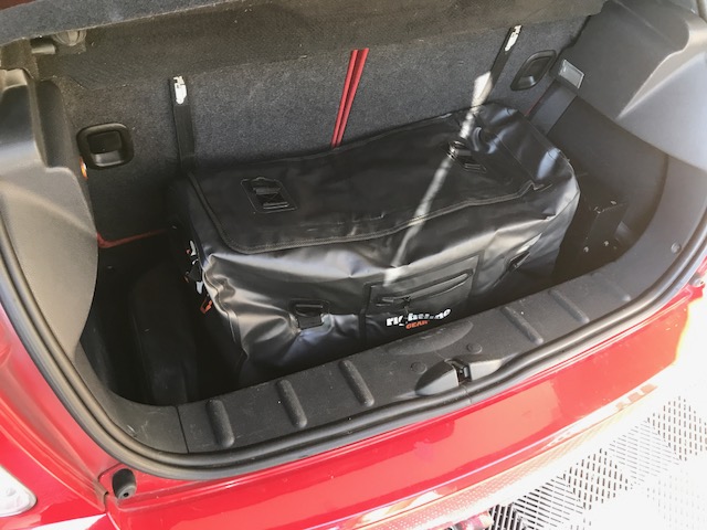

    Emergency Kit:
    Those of you who know me, know that I'm a bit crazy about preparedness. I always have a first-aid kit, tools, Slime, tire plugs, etc in the boot of my car. In the MINI, I frequently keep small spares like a belt, and a few other bits and pieces that I collect along the way, just in case.
    Because this is my first time having a 3rd car in the family, I had to get a new bag to hold all of my crap and Aaron over at www.Outmotoring.com had a nicely sized one. Since I was ordering a bunch of other stuff (to be documented as it arrives and is installed), I picked it up, along with a tow strap, a new first-aid kit, some granola bars and bottled water. Some emergency cash, the tool kit from my unplanned belt adventure in Louisiana and some other miscelaneous stuff is now riding in style:
