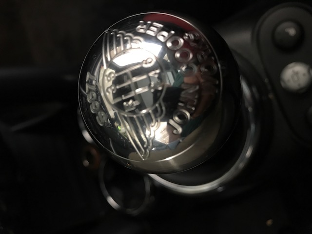

    I think my new Whalen handbrake handle arrives today (the stock one was peeling chrome everywhere) to match the shift knob. I still have my Whalen shift knob from Jango, for sentimental reasons and I was excited to put that on Rufus, but a previous owner already had a Whalen knob custom made with the JCW serial number engraved on the knob.
