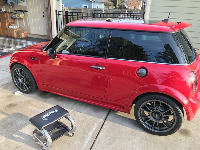

    Well, I decided to try and catch up today with all of my neglected Rufus work. My mother-in-law is visiting, so she and my wife went to the movies and shopping and I got busy out in the garage.
    1. Wash
    2. Claybar
    3. Medium polish with the PCDA
    4. Fine Polish with the PCDA
    5. Glass Polish
    6. Wash
    7. Installed the door handle covers (exterior, covered w/ carbon fiber vinyl)
    8. Applied the chrome beltline black-out tape
    9. Applied the first coat of Zaino Z5 and left it on to cure overnight
    I also got an hour or so of work done on the mother-in-law's car. I promised my wife I'd give it a good cleaning (exterior got run through the local drive-thru wash but I did give the interior a good cleaning at home) and checked all of the tires and fluids.
    I'm hoping to get through several coats of Zaino over the next 2 days and then I can call the outside done! Woo!
    I'm really digging the blacked-out beltline. Here's a photo of half of one side done, so you can see the effect. More photos to follow when all of the Zaino is layered on and everything is shiny!
    Oh yeah... I figured out why my rear wiper blade was a bit floppy... the arm broke where it attached to the motor shaft. ECS tuning to the rescue. A new arm is coming in a bit.

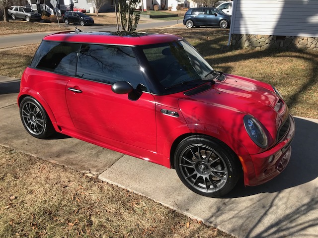

    Car looked great after the first coat of Zaino was buffed off. Coat 2 is curing now. Both of the first coats were Z5 (sealant w/ swirl-mark filler). At least 2 coats of Z2 (high-gloss sealant) will go on after those.

    Last coat of Zaino just went on (2 of Z5, 2 of Z2)! It's cold enough here that I'm going to let it sit overnight to really have a good chance to cure before I buff it all off. On a warm day, the first panel I seal is dry and cured before I finish the rest of the car. In Charlotte in January, I need to limit myself to 2 coats per day to let things tighten up before adding the next layer.
    While I was out working this weekend, I realized how incredibly lucky I am to have a daily driver in addition to Rufus so I can spend a week or more washing, polishing and sealing the car... and then store it for driving on nicer days and keep it clean and out of the weather. The deep engine refresh I'm about to take on will be immeasurably easier as well... I can leave the car in an undriveable state for weeks at a time with no issue. I'm a lucky guy.

    It was a good weekend!
    I got the last coat of Zaino buffed off and made it around the car a couple of times with detailing spray and Zaino's Ultimate Finish spray.
    I also sorted through all of the parts that I've been accumulating, organized the garage and preped Rufus for the next step, a deep engine service!
    I did get out for a nice 20 minute drive... really just to get the engine up to temp and running smoothly for a bit, cruise around the neighborhood, blast 2-3 exits down the highway, u-turn and head home. It's been mighty cold here and every start I've done lately was just 20-40 seconds of moving the car around the driveway.
