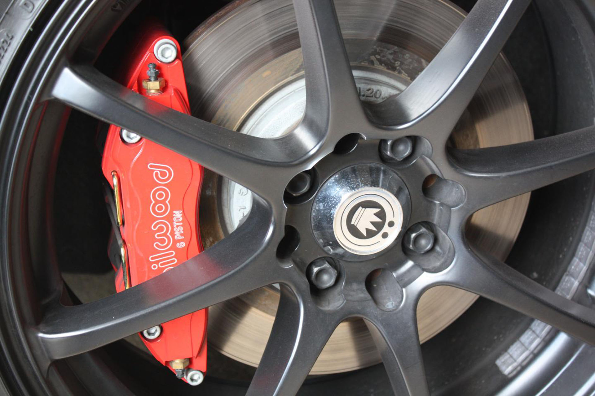

    I quickly assembled a hat and rotor at lunch, put pads on one of the front calipers and fit it inside one of the wheels. There was a TON of clearance. It's not a 100% test, but there was so much room that I'm not worried at all about things bolting up correctly. I did a quick fit as it's going to be a few weeks before I'm ready to mount the brakes and I didn't want to be calling Todd a month after he shipped saying "It doesn't fit!"
    The rotors are the black powder-coated ones (I assume whatever coating is on there will wear off almost immediately upon pad to rotor contact). It's kinda scary for me as my first set of Wilwoods were track abused and the hats had gone purple from heat... these are PURDY, not pre-abused for my convenience. I also went with drilled and slotted rotors. If I decide to go hard-core track use with the car (not in my immediate plans), I may get some plain or slotted-only rotors, but I decided for a bit of bling this time.
    I can't wait to see these peeking out from under the wheels, but I've got a bunch of engine work to do before I get to brakes and suspension... oh well.
