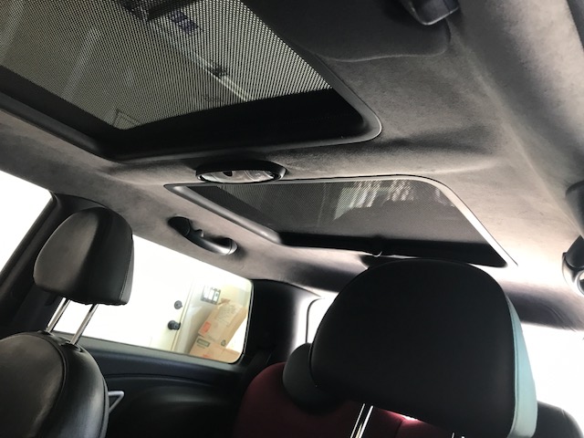

    I was still pondering the final style of the car, but I knew that the interior would need some help. The space cloth seats were nasty, as was the carpet, so I took all of the seats out and wet vacuumed them all several times. Several screws and the CD changer bracket got sanded and a fresh coat of black paint.
    While going over everything, I discovered that the headliner was worse than I thought, so a new sueded liner was put in. New dark grey gauge faces and a Whalen hand brake handle (to match the gear knob that has the JCW engine # engraved on it from owner #1) were fitted. Several other little bits and pieces were replaced or repaired to get everything looking clean and complete.

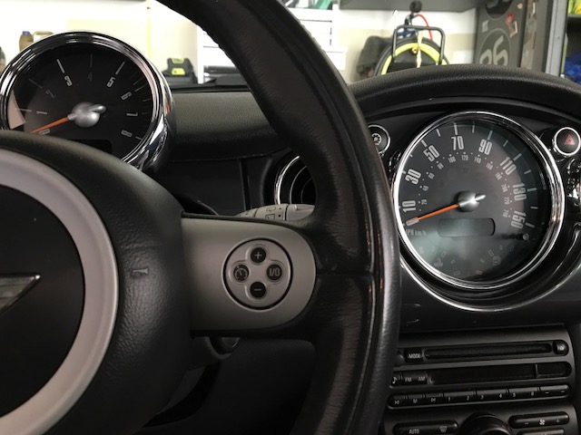

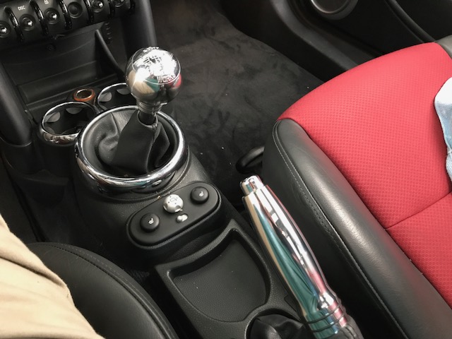

    As I moved on with styling the car, I decided to de-chrome almost everything. I bought some 3M DiNoc vinyl wrap in a medium-grey dry carbon fiber finish and went about learning how to apply vinyl. I did the 3-piece dash in this vinyl and I immediately loved losing all of the glare and reflections from the painted dash pieces. A new set of gauge faces in dark grey were sourced to replace the red/blue Union Jack faces that the previous owner had put on... they were nice, but not the vibe I was going for. The window tint was pretty well shot, so I had the old stuff removed and a fresh layer of ceramic tint applied in a nice dark grey.
    As a treat for myself, I got a new GPS unit, a Garmin DriveSmart61NA LMT-S (their big new edge-to-edge model)

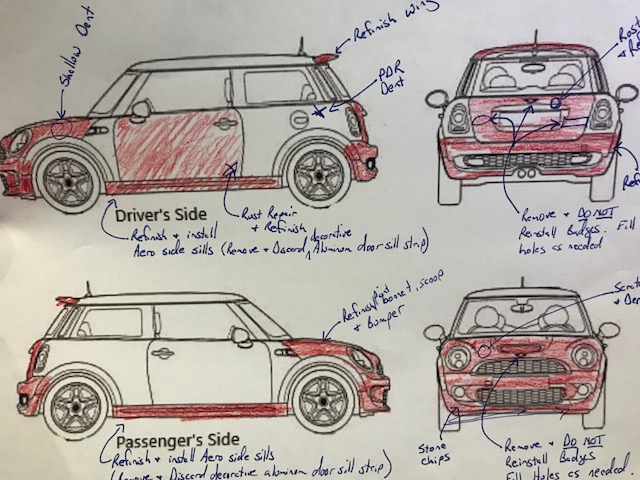

    BODY WORK
    There were several rust spots spread across the car, so I knew he was going to the body shop. About ½ of the body panels were repainted and those that weren’t got some PDR love. Both the bonnet and rear hatch were being painted, so I had them remove all of the badging and weld up the holes that were put there at the factory for badging (nose wipe and booty wipe).
    I had picked up some used aero side sills in Dallas on my way home with the car, so these got a fresh coat of paint and were mounted up.
    Anything in red color pencil was repainted!
