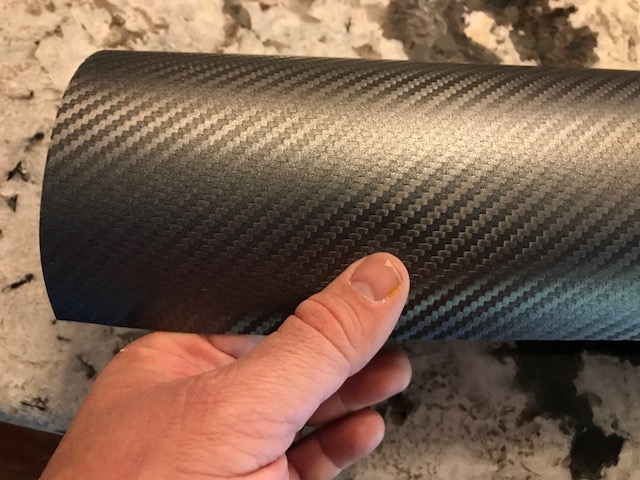

    Oh yeah... another package arrived late today... an 8'x4' rectangle of 3M Di-Noc in a medium grey dry carbon weave. The color seems to match the painted interior bits perfectly (dash, door ovals). It's supposed to be the most realistic carbon fiber vinyl out there.
    I'd love to start playing with it, but I've gotta wait for some 3M primer to arrive. Apparently it's a flight restricted substance, so it ships via UPS ground.

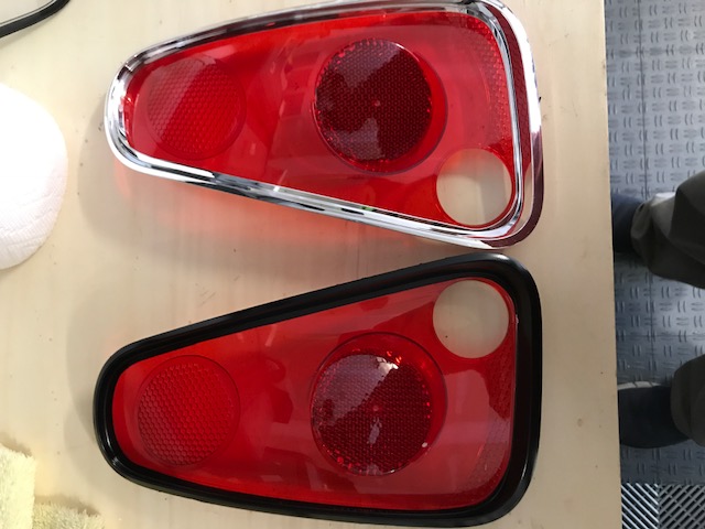

    Tail lights:
    I took one of the tail lights out yesterday. They are seriously cloudy / hazy and really detract from the look. I polished out a test spot on the lens, only to wind up with a perfectly smooth cloudy lens. I'm going to crack the housing open later today, to see if it can be polished out from the inside. If that works, I'll probably black out the interior chrome trim before sealing it back up.
  8. Dave.0
    ^^^ Yeah it "in" the cheap plastic they used back then because it's not on the inside either. Sorry but it's better to just bite the bullet and buy a new set that's what I did. OEM ones at the dealership are not that expensive and look the best.
    With the new set I taped them off, fully covering the lens and used a dremel and cut them open and blacked out the chrome trim ring inside. They are easy to seal back up with no leaks.

    Well... the MA team is proven right again. I opened up one of the lights (baked at 250 for 7 min, pry carefully... repeat until the front plastic lens pops off... BTW, you run the risk of cracking the lens... especially if it is old and brittle from sun exposure) and confirmed that it is in the full depth of the outer lens. A new pair of factory tail lights are on the way, along with a few other bits (black-out tape, a gasket, a JCW badge and some cool puddle lights with th JCW logo (for $20, I couldn't resist).

    Tail Lights:
    I got the tail light assemblies out last week and got the lenses off the front. I baked one lens off, but developed small cracks from prying a bit too much. I tested polishing this one out and discovered that the yellowing/hazing goes all the way through the lens, so I ordered a set of OEM replacements. I dremmeled off the second outer lens from the other set and pulled both inner lenses (pristine). I cleaned them both well with Isopropyl Alcohol to degrease and prep for paint, which had the added bonus of removing the chrome trim painting from the inner lens (Really! The chrome paint came right off w/ 70% IPA and rubbing with a paper towel).
    When the new set arrives, I'll probably dremmel off the outer lenses, install the old inner lenses that I painted this weekend (satin black spray paint) and epoxy everything back together again, leaving the stock beta-link tape in place. I cut the lenses about 1/2 cm in from the most forward edge of the outer lens, so the epoxy seam will be completely hidden.
