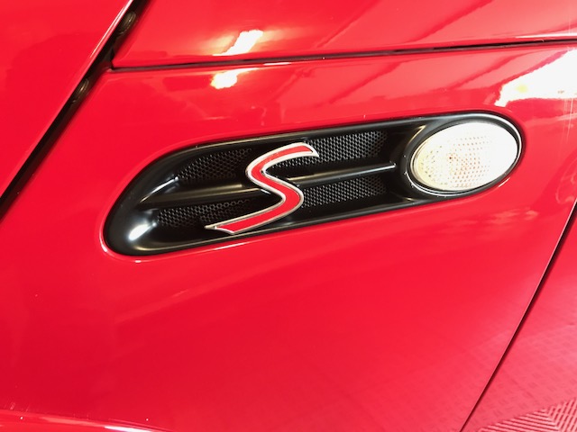

    I've also got another small project going... It sure was nice of MINI to make these side scuttles in a way so that I can take 'em apart for painting instead of having to mask off the deep nooks and crannies. :D
    The disassembly wasn't too bad. You use a body panel tool (thin plastic screwdriver) to pry out the leading edge of the scuttle from the hole in the body panel. Detatch the light wiring. Use a flat bladed jeweler's screwdriver to loosen the quick-nut on the back and then use that same driver to pry the black plastic grill off and (from the back) pry the edges of the 'S' loose... there is some glue in there holding everything together and you just need to break that bond. Then press on the stem where the quick-nut was attached and the 'S' pops off. Looks like I'll be running out for paint at lunch. Hmmm... I wonder if I can vinyl wrap the main chrome bit...

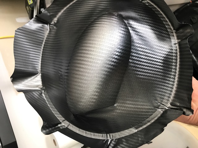

    The answer: No. No, you can't vinyl wrap the side scuttle (or at least not with my skill). Unfortunately the part is deeper than the width of the two vanes that run down the length of it. If you cover the piece with vinyl and slit it right down the middle, you don't have enough material left to cover the chrome all the way down to the plastic backing piece.
    Oh well. It was a nice, quick try and I learned that the 3M Di-Noc is a breeze to work with. It is amazing how rigid it becomes when it is at room temp and then how stretchy-floppy it becomes with just a few seconds of heat from a heat gun. Give it 20 seconds to cool and it goes rigid again. Wrinkles pop right out with a bit of heat. Very nice, forgiving stuff to work with! I also learned that it REALLY sticks to the surface that you apply the primer to and it leaves a sticky snot-like substance behind when you peel it away that takes 5-6 passes with goo-gone and IPA to make it go away.

    Ok... I sprayed the side scuttles black with a coat of matte clear on top. Between coats of paint, I polished out the other plastic bits. I couldn't resist sneaking out a few hours later while taking the dogs out for the 10pm walk, assembling one and fitting it. My only question: Why in the hell doesn't everyone do this? These things are spectacular! I wish I had done this in PW for Jango years ago!
    Photos to come soon.

    Side Scuttles!

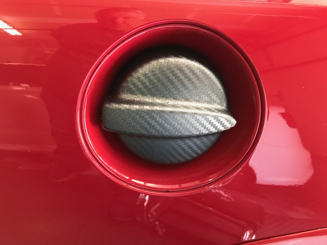

    Gas cap: wrapped in 3M Di-Noc

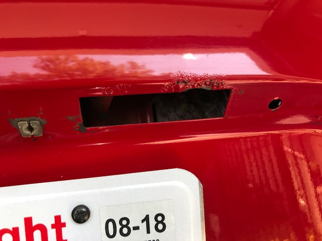

    Uh oh... RUST on the rear hatch! I saw the bubbles under there, but was hoping it was bad touch-up paint work. Once I got the rear hatch handle off, it was pretty clear that I've got some rust going on under there. :( I'll need to figure out what to do there.

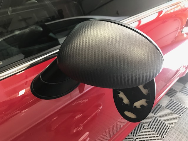

    Wrapping the side-view mirror covers:
    I had to d something with the mirror caps. The chrome was a bit much for me and they both had some pretty big dings on 'em. The vinyl is pretty forgiving, so I just sand d the dings down, cleaned everything well with IPA, applied a good coat of 3M primer and got wrapping.

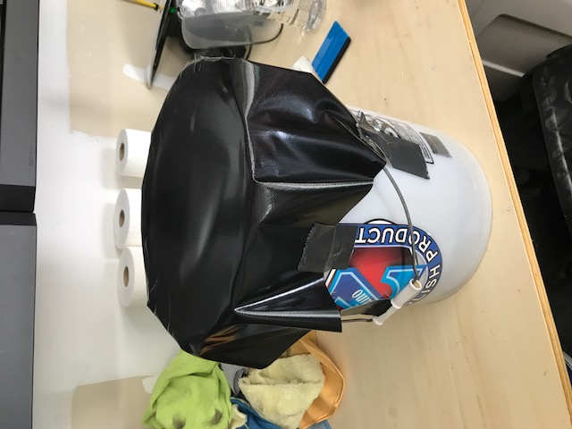

    I went on YouTube and found a great video on how to wrap complex shapes like our mirror caps. You stretch vinyl over a bucket, tape it on, apply a good bit of heat to soften the material and then press down into the vinyl. Go as far as you can, then let it cool and cut everything free, leaving as much excess vinyl as you can. Then you heat/stretch/heat to set the rest of the material smoothly.
    [ame="https://m.youtube.com/watch?v=nEAmVzBL328"]Vinyl Wrap on Mini Cooper Mirrors Caps - YouTube[/ame]
    Here's the bucket, set up and ready to go:
    Here's the middle step, after pressing the mirror down into the vinyl.
    And here's the end (well... I've gotta reinstall the cover and mirror, but I had to run, so it got set on for photographic purposes.

    The scuttles and vinyl look great! You might try bringing the car to the dealer to see if they'll still do anything for the rust. The warranty was extended to 12 years and many people are still getting free repairs.

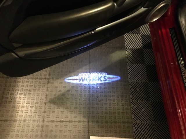

    Puddle lights:
    For $20 at Out Motoring, I couldn't resist. It took all of 5 minutes, at the most.

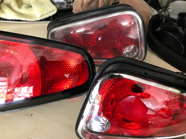

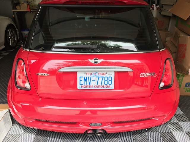

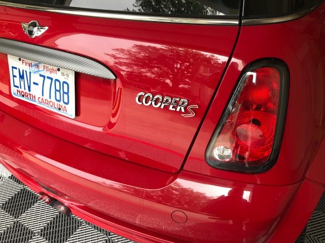

    Tail Lights:

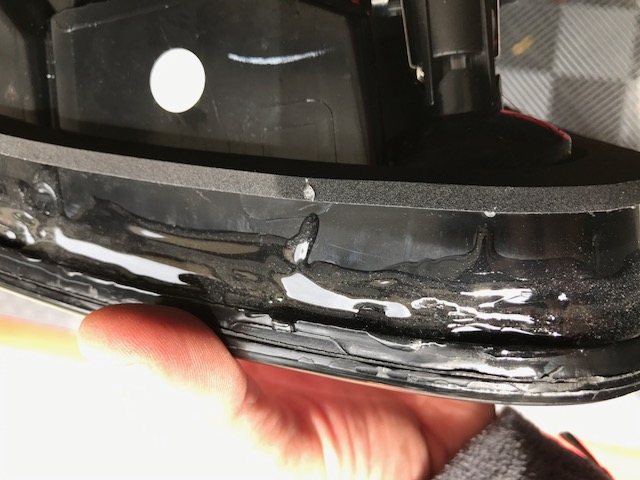

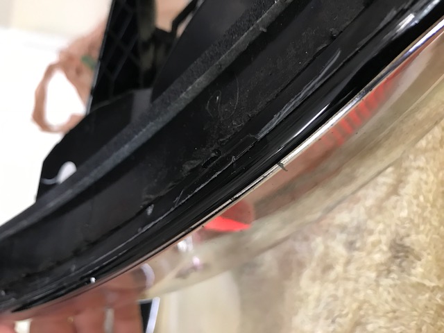

    I had already painted my old interior lenses to remove the chrome, so I dremeled off the outer lenses of a new set of tail lights, removed the new inner lenses (that has the color/chrome on 'em), de-burred the housings (the dremel cut-off wheels really melt their way through the paint, not cut), cleaned everything up and used 2 part plastic epoxy to seal everything back up again.
    The cut... this is deep enough to get the outer lens off but not so deep that you can't extract the inner lens from it once the housing is opened.
    I strongly recommend using the dremmel cut-off technique instead of the bake/pry technique that I mentioned earlier in this thread. The bake/pry technique may be OK on newer lenses, but my old ones had spent 12 years in sunlight and TX heat, becoming more and more brittle. I got a few cracks in one of the old lenses (they were yellow and cloudy... was using them for practice more than anything) and I found the cut-off technique to be much safer... more involved and butcher feeling (nothing like taking a dremmel to a brand new $100 part), but safer to the outer lens in the end.
    Lots of epoxy... 2 rounds, to be safe.
    The ultimate before, middle and after shot. The rear lens is the before... a permanently yellowed/hazy lens. The new lens is show on the right and the finished, black-out lens is on the left.
    Finished!
    BEFORE:
    AFTER:
    Note the carbon fiber wrap on the boot handle cover. I spent almost an hour peeling/scrubbing away the old, deteriorating gasket between this bit and the boot (one side has adhesive - $14 at Out Motoring), but it really cleaned things up and allowed me to get the vinyl wrap up under the gasket, so the vinyl wraps under the piece on the top side for a 1/4-1/2", for a much better finished look and durability. I polished out the paintwork under and around the handle... much easier to do while it's off.

    Does the mirror have a slight wave to the carbon look? Or is that a trick of the camera?
  18. fishmonger
    fishmonger Well-Known Member
    May 13, 2015
    984
    769
    Madison, WI
    +895 / 0 / -0
    It looks like a little too much stretching in that direction. That's a risk when you use a wrap that has a pattern on a complex shape. To get that last wrinkle out, you heat and pull in some places you should not pull in order to keep the pattern straight.
  19. agranger
    #79 agranger, Sep 11, 2017
    Yep. FM got it right. You can see that I got the first 2/3 of the vinyl applied using the bucket trick. The last bit required hand stretching/working with heat and I got a bit of a wave in there. Honestly, I was really focused on just getting the vinyl SMOOTH... getting both SMOOTH and EVEN pattern is going to take some additional focus! I've learned, over the course of doing a few more pieces this weekend, that I need to figure out the most visible aspect of each piece and focus on that early in the work. If you need to cheat a corner, introduce a wave from heavier stretching or put in a little relief cut, it's much better if you do that on the underside of the piece. I'm getting better! :D
    I got out this morning for a few moments and decided to fit the mirror cap that I wrapped, only to discover that a few of the mirror cover tabs were broken and the others were VERY brittle. I know that they are fragile, but these suckers seemed to break when I looked at 'em. I decided to order some new mirror caps and start over. I'll see if I can get both smooth AND even in the next pass.

    I heard back from my service manager... Rufus was delivered 13 years and 1 month ago, so the 12 month rust warranty (2005 and forward, even in Canada) is gone.
    I also found another small bubble of rust on the driver's side door (paint bubbling, but no perforation yet).
