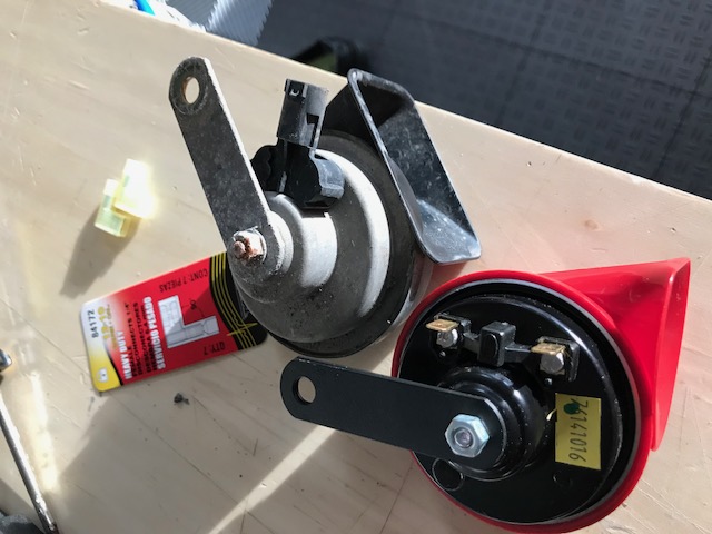

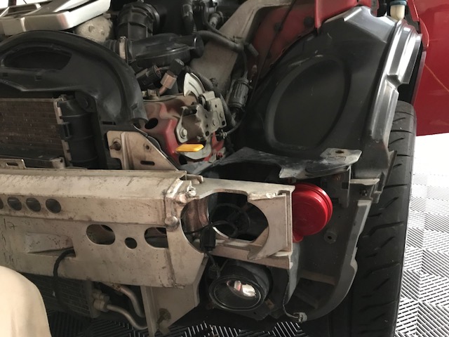

    2) I took the front bumper off to replace the turn signal housings/lenses. While I was there I polished out the lenses for the lower lights and started the install of the new horns. I was down to a one-note horn (should be 2-tone), so hopefully the issue is at the horn and replacing them will fix the problem. I'll have to make a run to a parts store this afternoon... I'll need some spade connectors to be able to make an adapter to switch from the old horn connections to the new.
    3) While I had the bumper off, I decided to get out the Black Wow and refresh the Aero Grills. I love Black Wow, but man... that grill is a serious PITA to get all of the honeycomb covered. I finally got a medium-stiff detailing brush, dabbed it in some Black Wow and then stipple painted the entire surface. I also got the JCW badge removed and the club grill badges mounted, though it looks pretty nasty on that front bumper.

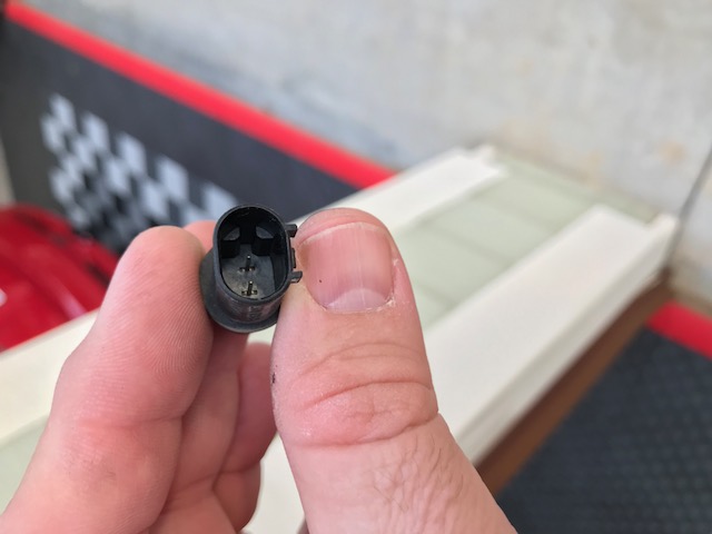

    I noticed that I only had one horn, but I know that MiNIs have 2. I bought the horn upgrade from Outmotori g a while back and started to fit them last weekend. They bolt right on, but you have to do some wiring to convert the socket from the factory wiring loom to the spade connectors on the new horns. I found that the factory wiring harness almost matches the light socket on the new arch reflectors / corner lights, so I engineered a solution that looks great. You have to Dremel out some plastic bits on the inside of the plugs, but it looks pretty factory, if I must say so myself!
    This is the arch reflector socket. If you use a small Dremel carving bit and chew away the 2 little shoulders inside on the right, you can use this piece to connect into the wiring harness. Add 6-8" of wire and some female spade bit ends and you can connect in to the new horns without cutting in to the factory wiring
    Here you can see the standard spade connectors on the new horns and the factory wiring connector.
