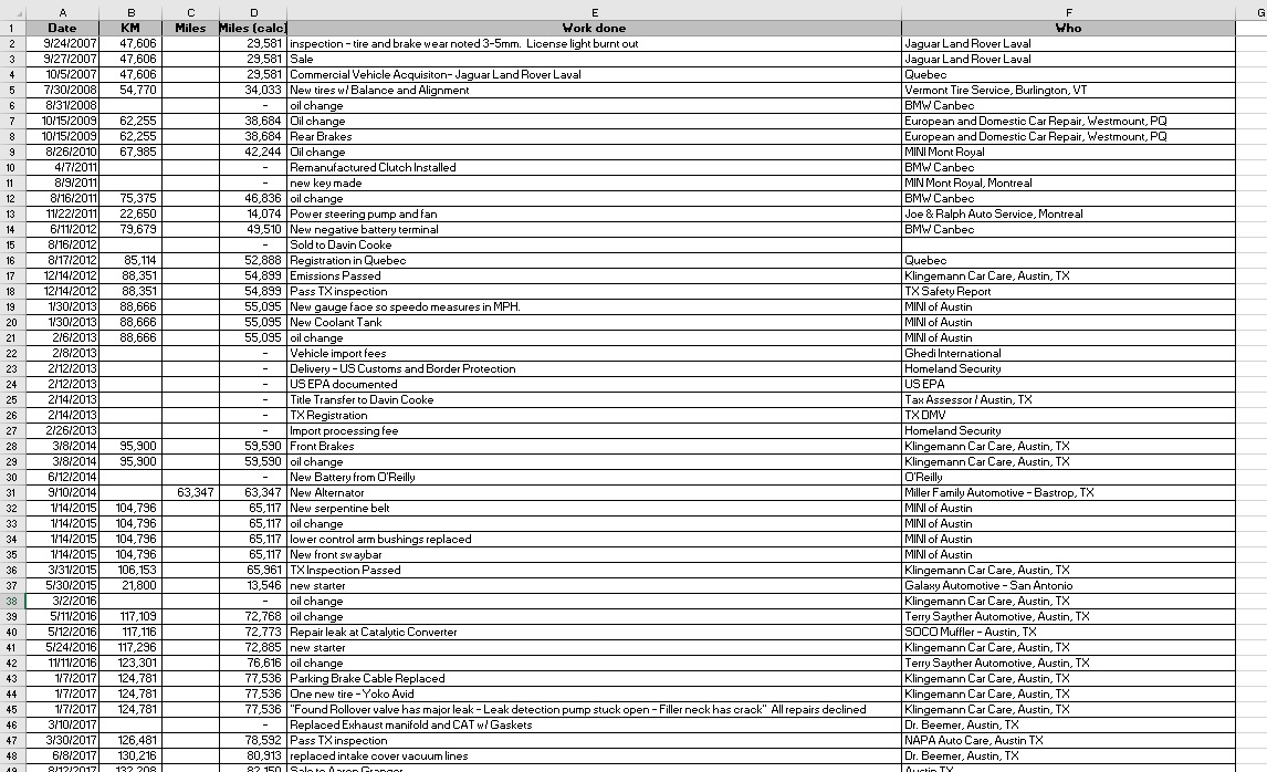

    I spent way too much time last night sorting through the 2" thick pile of paperwork that the previous owner of Rufus passed along to me. Most of it was service records, with a close second of import paperwork and letters to US Customs and Homeland Security to allow the car to move from Canada to Texas. I decided to create an Excel sheet, so I could order it all by date and get a comprehensive picture of what has happened to Rufus before I got him.
    A few surprises:
    1. He became a US Citizen in early 2013... so 8 years in the salt.
    2. If you know another romance language, French service records aren't too hard to read
    3. Translate.google.com is a wonderful thing
    4. In the past few years, he got a new Alternator, control arm bushings, front swaybar (was rusted through - yikes!), starter, exhaust manifold w/ Cat
    5. "Leak found in the rollover valve and a crack in the filler neck" was noted on a service document and the service declined by the previous owner.
    It looks like I get to go crawling around under the car this weekend to see what can be done about the filler neck ($120 new). I've been all over the RealOEM diagrams and can't find mention of a roll-over valve on the fuel system... Anyone? Bueler?

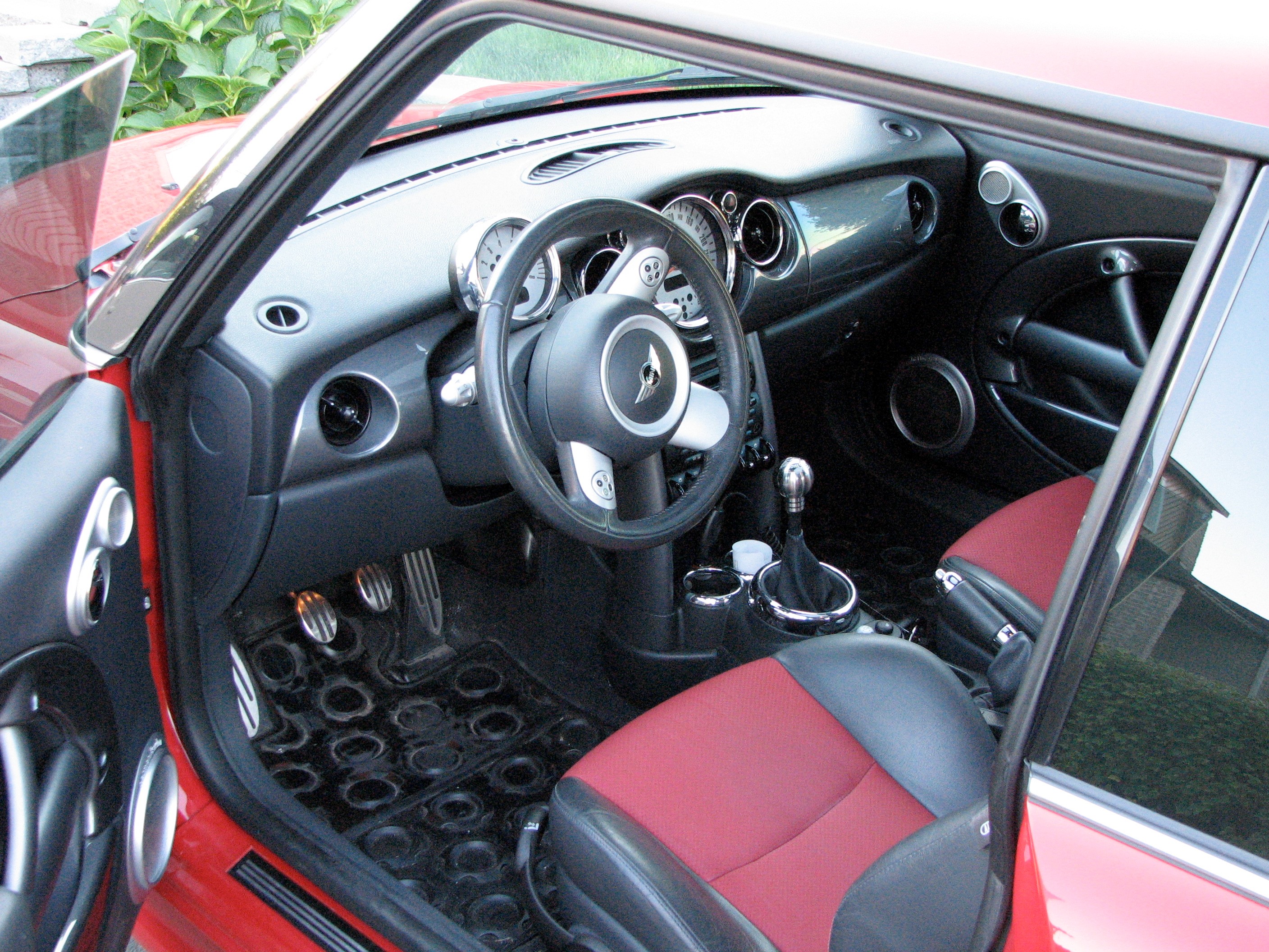

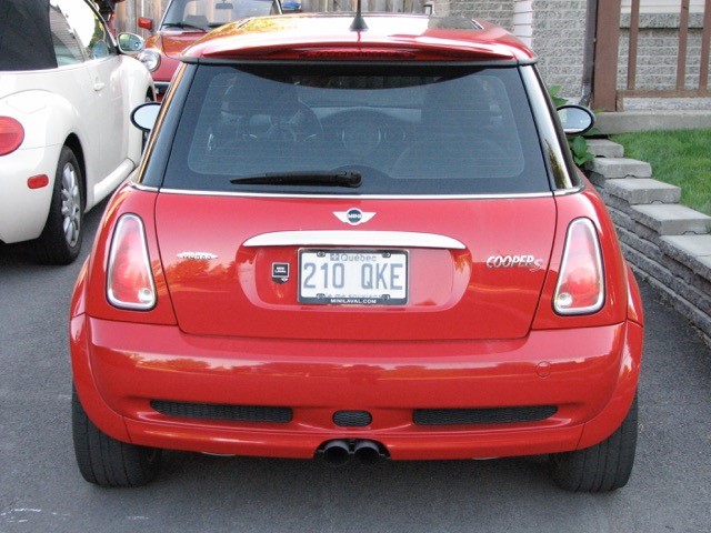

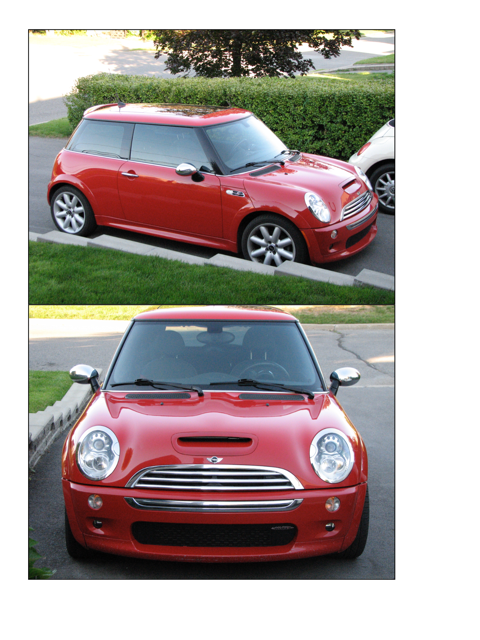

    Another surprise from the stack of documents... the name of the first owner! I'm #3. From Davin, owner #2, I knew that #1 was a doctor in Canada and with the name, city and job, Google was able to find him! I popped into his website and sent a message. Well... I just got a nice long letter from him, including photos from when Brutus (formerly known as the Beast) was brand new! Hi Ben!
    Some of the photos he sent from when Brutus was 2-3 years old:
