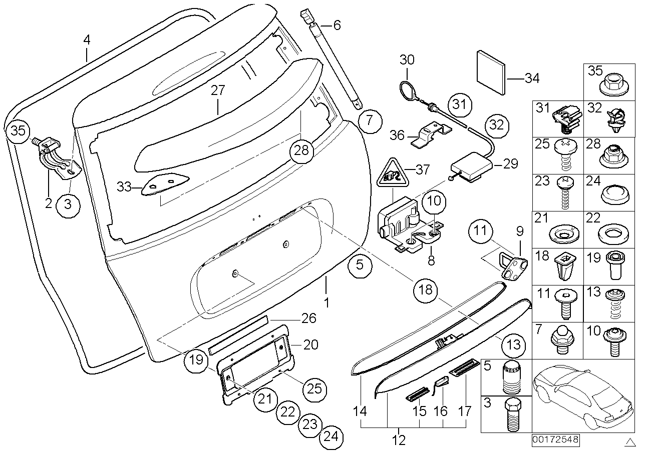

    I have discovered that the screws that were used to secure the rear tag on my Cabriolet are frozen in the nylon holders. Any attempts to remove them only results in the nylon insert turning in the hole. I cannot access them even by taking the truck cover off. They appear to be inserted into another section of the sheet metal. Anyone have any ideas? I may have to resort to messing up the tag to pry the nylon out and then get new inserts.

    You're talking about the screws that hold the plate to the holder......... or the screws that attach the holder to the actual hatch?
    Are you struggling with 4 screws or 2?

    I have the same problem on my R53 hatchback, in the back. The screw heads holding the plate to the holder are stripped and penetrating oil doesn't work. Do I just break off the tag holder and use a locking wrench to try to twist the screws loose, or do I consider cutting off the screws with a hacksaw and probably really having an even worse problem on my hands? I will entertain any reasonable suggestions.
  4. Savvy
    Get a piece of 1"x lumber behind those 4 mounting screws and drill them out. Carefully. Then just get yourself a new plate holder. It's really all you can do.

    This happened to me too. I ended bending the plate up and removing the whole bracket from the car. I was able to get them off but I destroyed some pieces in the process. Bought new inserts for the car that the screws go into, and new screws and bracket from the dealer.

    I tried to take the cover off from inside but couldn't see any access to behind the screws anyway. Looks like drilling is the only way.
  7. Savvy
    You are talking about the two screws for the actual holder?! (#20 in the pic)
    You're saying that the #19 nutserts are spinning in the actual hatch? If so, good luck. I've never seen those strip loose.

    The car is a convertible, but the screw inserts that are spinning are the ones that hold the plate screws, not the frame screws. It's all the same in the long run since on the vert we have a double set of those inserts. Drilling them out seems like the only solution. My stupidity was not replacing them originally with S/S hardware.
  9. Savvy
    Ok. So, yeah... drill those plate screws out. It's really all you can do, unless you feel like cutting your plate. Or you have some magic kind of snip that you can get in between the plate and the hatch to snip the holder itself.
