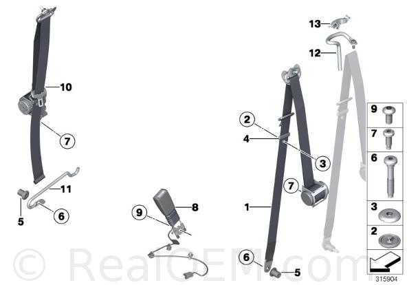

    I had this problem with Mr Salt and the reqular seat belts. I went to Mini and purchased a pair of plastic seat belt "buttons". I put one of them them on each the seat belt straps so that the male piece can not slide all the way down. The seat belt retracts and the "button" does not restrict putting the belt on. I think they were two dollars each. Chance are you already have them on the seat belts and they are down at the bottom----they can not be removed so will need to buy new ones.
  5. Angib
    That would be items 2 and 3 'buttons' - part numbers 72111950829 and 72111917406. Possibly also item 4 described as 'clamping' - part number 72111862636. All under $1 list each.
  6. Mr Salt
    Mr Salt New Member
    Mar 30, 2013
    40
    23
    +23 / 0 / -0
    I clipped the parts 2 and 3 together with a pair of pliers. You don't have to think about it, just let go of the seat belt the button holds the buckle in place and the belt retracts. It will stop at the top and if properly installed there will be no tension on the belt other than there normally would be without the stop.
