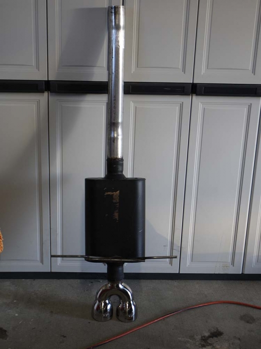

    Mine's actually the Checkmate in the Exhaust Sound Off thread... 2.25" under the batt box, including 2 inline louvered SS glasspacks and a corvette tip... and available commercially in stainless from G4 (see Mark's post, below...), it's also available in several versions, from mildly aggressive to "holy crap".

    Hi folks. I'm the new owner of Dr. Phil's Mini. I have to say the car is awesome. Except for the exhaust. It was left with the straight pipe exaust system pictured at the start of this thread.
    Removing this has become my top priority for the car. The reason: The 5 hour drive from Tacoma (where I bought it) to home in Spokane WA was probably the worst and best time I've ever had in a 'new to me' car. Best in that the car handled and drove very well. The worst because of the horrible drone at highway speeds. And 5 hours of it was damn near torture.
    Luckily I had the earplugs I carry with me for flights on Q400's. Otherwise I might have stopped and had the car towed! It was that bad.
    Now that I've had it home for a couple weeks, I've had a chance to do some research on different exhausts and found this thread.
    So, I'll be un-doing the straight through exhaust and replacing it with a dual muffler design (not decided on which one yet) and will be relocating the battery back to where it was.
    This means I'm going to fabricate a new battery box and in my mind, correcting a pretty bad mistake by the previous owner.
