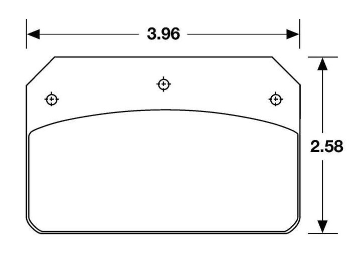

    What pads will fit on the calipers of this kit? (Are they the same fitment as the stock calipers?). Thanks!
    Stock won't even come close.
    It uses the PFC 752 or HB 100 pad type.
    OK, that is really helpful I hear you saying.
    Those pad types correspond to a known shape of brake pad.
    HB is Hawks numbering system, PFC is Performance Friction's system. These are standardized across the industry. The HB100/PFC752 is a very common type with a host of compounds.
