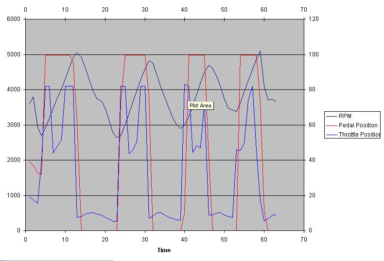

    Remember - the only symptom I see is this:
    100% accelerator pedal input results in momentary WOT, then throttle closes to about 50%, then when I pass 4000RPM it opens back up to WOT.

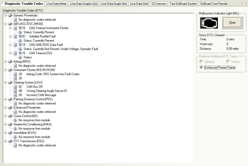

    While the car isn't producing any drivetrain P-codes, it DOES have some persistent CAN errors:
    Just starting to dig into these as I only got a scantool that could see them yesterday. But I suspect they've been there a while, as Dan Z said he saw some codes like this when he scanned my car a while back.
    Ideas? Related? Unrelated? Possible causes? Troubleshooting suggestions?

    If the alternator is in "release mode" at WOT, then the there could be a voltage drop. As seen in the 5E19 section of that screen shot.
    That could cause it, a weak battery, or a bad ground somewhere along the way.
    Low voltage can also "starve" the coil, resulting in a rich condition.
