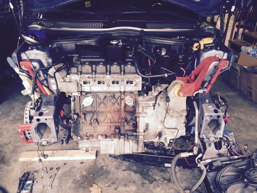

    So, this happened.
    Took all weekend, but the engine is out and the garage is usable as a garage again, mostly.
    FWIW, getting the engine out on an MCSA is a b!tch. The whole assembly is a good bit fatter than with the manual, and the transmission is much fatter than the manual. And comes with it's own assortment of extra water hoses, vacuum lines, and wiring harness that the manual doesn't have.

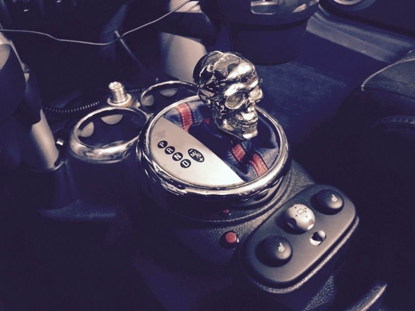

  10. BlimeyCabrio
    Somebody said I needed a "short shifter"
    So I installed one.

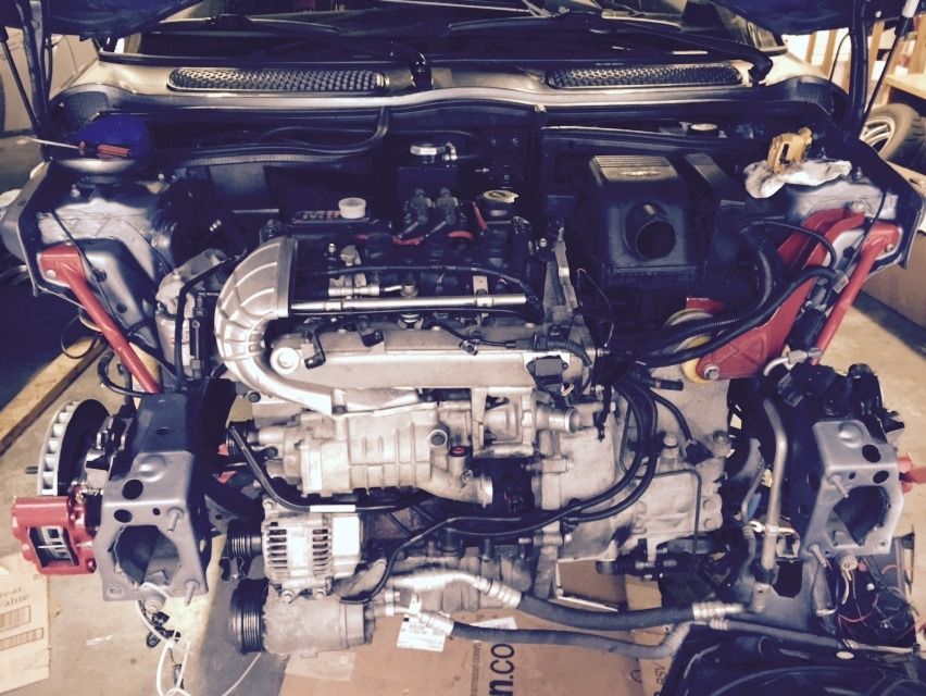

    Took a while to get the clutch lines run and connected. Then got the engine hung.
    Took a lonnnnnng time to bleed the clutch. Had a line connection pop loose in the footwell while working on it... what a mess. But eventually got the clutch working as it should, and the shift cables connected.... and I sat in the car, clutched and shifted, and made race car sounds. Bliss.
    Used Autoenginuity to do an ABS air bleed on all four corners, since I had the DSC out of the car for painting.
    Things started going pretty fast after that. Installed the manual engine harness. Got all the connections and heat shields done on the rear of the engine, and header installed. New reman axles installed, had to move the pillow block over from the old axles. Wellzy was a huge help with all of this.
    Started getting the front of the engine buttoned up.
    Have probably 90 minutes of work tomorrow morning to get pulleys / tensioner / belt on, fluids in, throttle and rest of air ducts on, radiator back on. Jan sent me a base tune file for it today, and I have it on my flash loader, ready to install. Then FIRE IT UP.

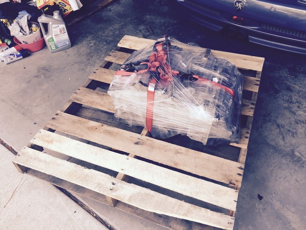

  17. BlimeyCabrio
    GP motor, ready to take a little trip...
