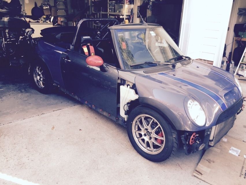

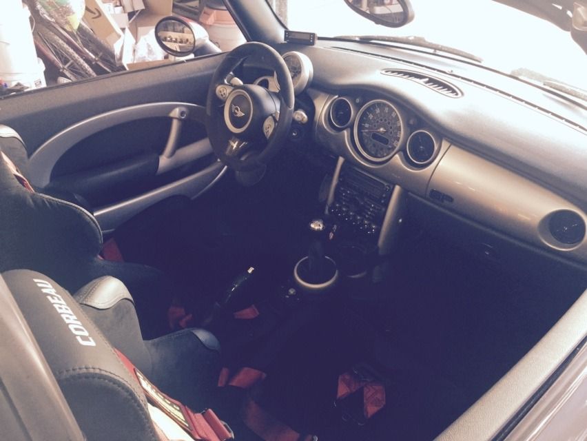

    Got the rest of the interior swapped over and the doors hung. Only cabrio with GP doors and dash, I bet...
    Still need to hang the A-panels and bumper bits, sort out a few coding issues, reset steering angle sensor, etc. I don't have "reverse" lights, which is an issue, but I'll get that sorted. I know how to do it by brute force if necessary.
    I'll hang the GP side skirts after I install the rear suspension arms and get an alignment.
    Oh yeah, and I pushed the "top up" button, and the top worked, after being down for MONTHS because it didn't work the last time I tried. WTF? I'm not complaining.
    But it's soooooo good right now. I know I can work through the other piddly stuff. It's running, it's solid, it will light up the tires... it's gonna be a beast at MOTD.

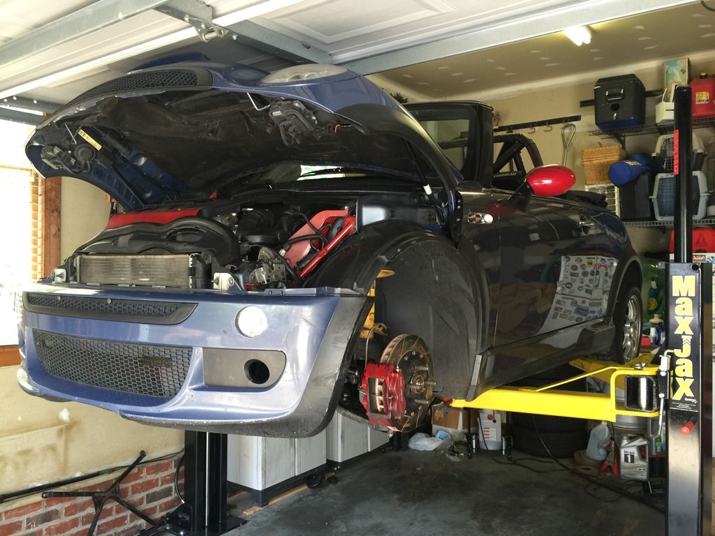

    Ordered the MaxJax a couple of months ago, they were on backorder and had to wait for a new shipment to come across the pond. Arrived today like this:
    I ordered from Scott Matthews at Big Boys Garage Toys. He had a great price and great service and communications. I ordered online on a Sunday. He called me within 10 minutes (on Sunday) to let me know the unit was on backorder, gave me an ETA, and made sure that was OK. The shipment arrived when he said it would, it shipped immediately from the distributor, Scott notified me that it had shipped and provided a tracking number. The unit made it cross country in only three days via Con-Way freight. Delivered to my driveway in perfect condition. Couldn't ask for more.
    Really brilliant packaging, actually.
    15 seconds to cut off the plastic and one plastic strap, and move one box, and you have this:
    One minute to cut three steel straps, move the arms, a couple of boxes, a few other large parts and some cardboard, and you have this:
    A few minutes to put on 4 wheels, remove 10 bolts connecting the end frames, stand things up and roll into the garage. Done with unpacking. Total time to unpack from the shipping frame: about 10 minutes. Easy Peasy. Helps to use a floor jack to lift under the uprights a bit to remove the ends.
    When you're done, this is all that's left over - these end frames, three steel straps, one plastic strap, 10 bolts, some cardboard and some plastic wrap turn the MaxJax system into a single shippable, stackable unit. Pretty smart.

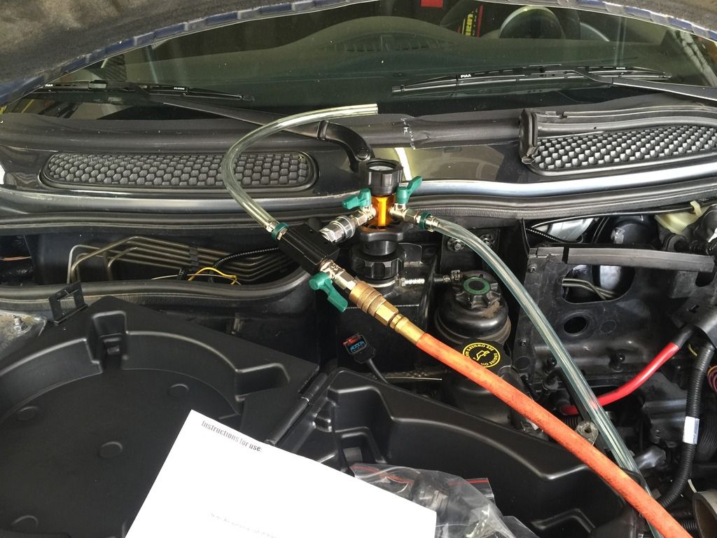

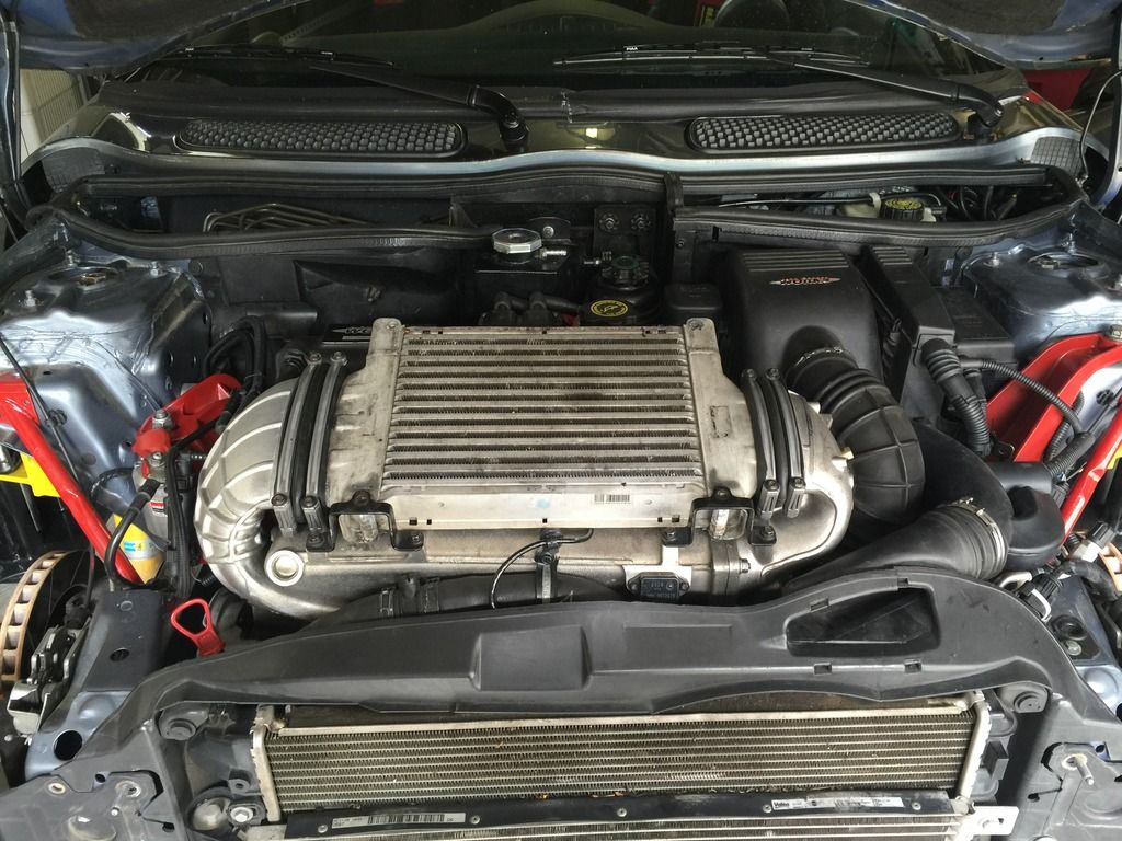

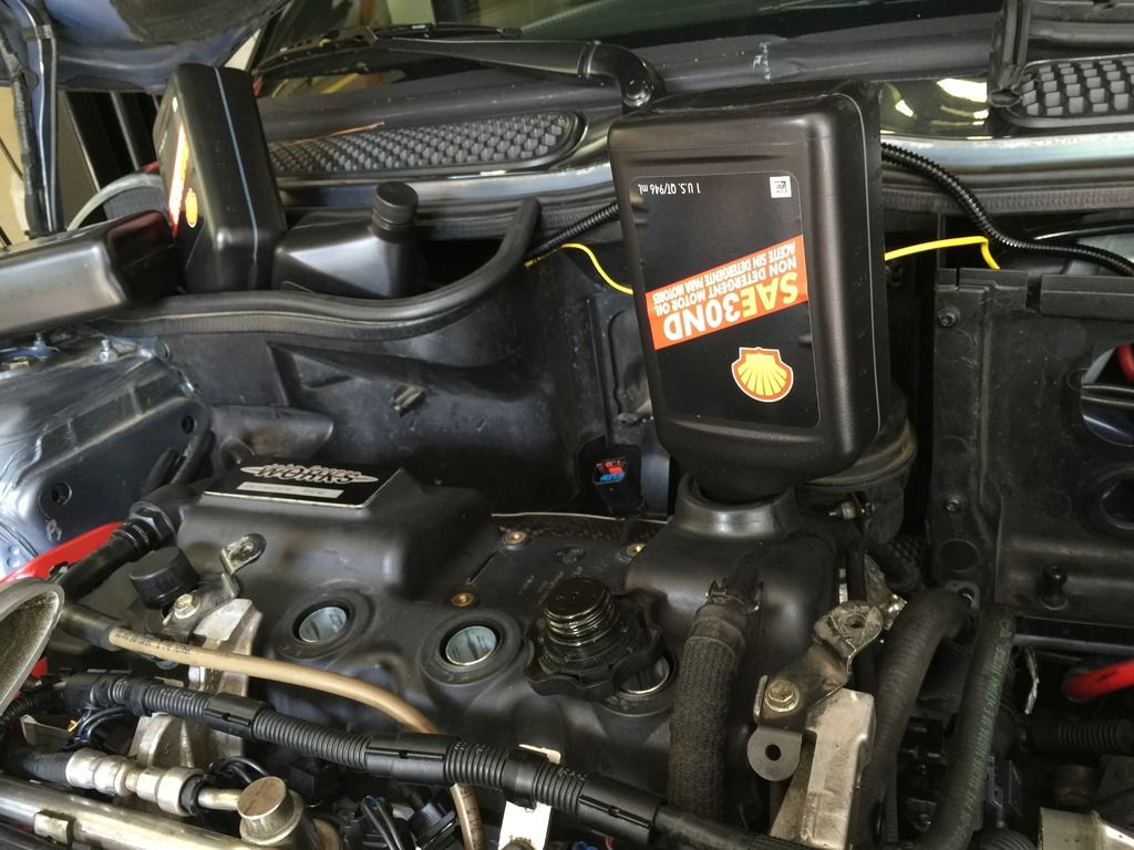

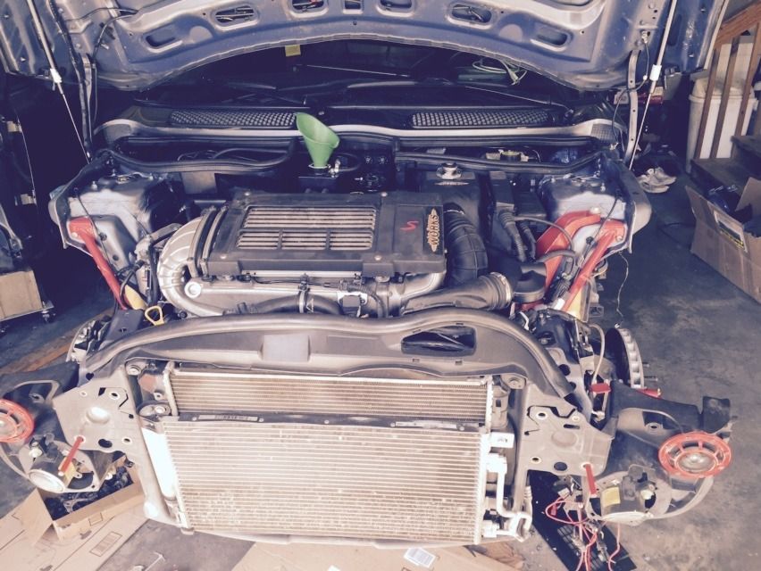

    Finished getting the engine hooked up.

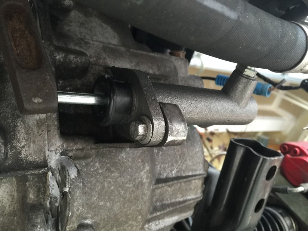

    Installed Greene Performance uprated clutch slave while things were apart. Old OEM slave was starting to seep. This one is a bit stiffer and has much more "feel".
    Did the first oil fill - this is just for the initial firing and warm-up. Non-detergent lawn mower oil. Replaced with Rotella T for break-in, after the first warm-up.
    Used my Schwaben cooling system evacuation tool to fill the cooling system. This thing is awesome, draws a vacuum on the cooling system and then fills, so it doesn't need bleeding.
    Pulled the plugs, pulled the fuel pump fuse, and ran the starter a couple of long cycles to prime the new motor with oil.
    Then reinstall plugs, intercooler and fuel pump fuse. Loaded new RMW tune to support 550cc injectors.
    Ready to Fire!!!
    [ame="http://www.youtube.com/watch?v=62yBqKDuXWc"]Firing the RMW Stroker - YouTube[/ame]

    The MaxJax is a mid-rise lift, 48".
    Perfect height for rolling around on one of these:
    I always thought I wanted a 6' lift... but after having this, there's really no reason to have a taller lift unless you're going to store another car underneath. Rolling around on the stool is better than standing / walking under the car - faster and more cozy.
    I agree it looks like your bar just kept the car off you in its final landing place. It is relatively untouched considering the condition of the rest of your car. Go buy a lottery ticket you are a lucky guy.
