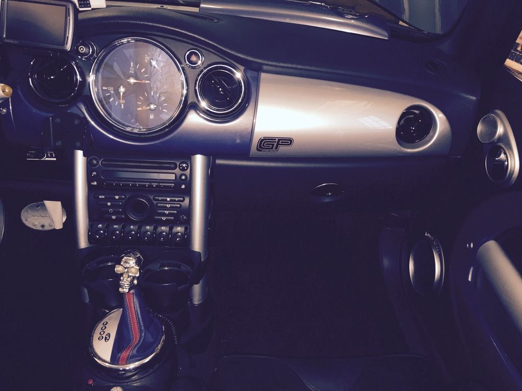

    On the outside, everything from the front wheels to the rear wheels is in nearly perfect condition. Skirts and underbody panels are intact. I can reuse all of the front bumper parts except the painted cover. Wing spoiler looks perfect. Wheels look perfect. Actually has a Milltek exhaust on it, bent just a little, but should be easily fixable.
    Interior is dirty, but in good condition. Luckily someone figured out how to get the windows closed. Drivers seat is broken and both seats are worn, so Chris may get his seat sensor. :) We'll see. Everything I need from the interior should be fine, though it may be a few weeks before I start putting any energy into interior work.

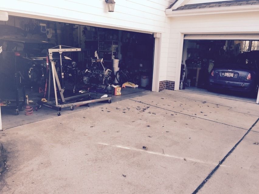

    FrankenGP: Weekend One
    Long weekend, I probably put in close to 20 hours on the car. Made much progress.
    I'll do a more detailed writeup on my blog in the next day or two - but here are some highlights:

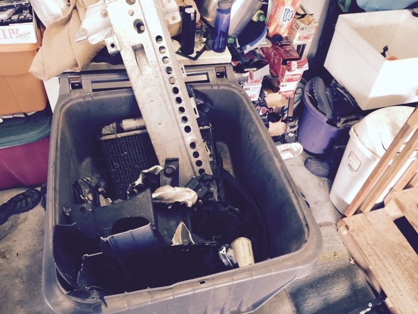

    Most things on the front of the engine were pretty crushed, as expected. Casualties included:
    • Radiator
    • AC Condensor
    • Alternator
    • Intake Manifold
    • SC Intake duct
    • Snorkel
    • JCW Airbox (sadly - cracked)
    • Transmission mount
    • Lower engine mount
    • Bumper cover
    • Alloy Bumper
    • Fan assembly
    • Valve Cover
    • Coil
    • Intercooler cover
    That's a lot, but only a few things in there I didn't expect, and none that are critical to my project.

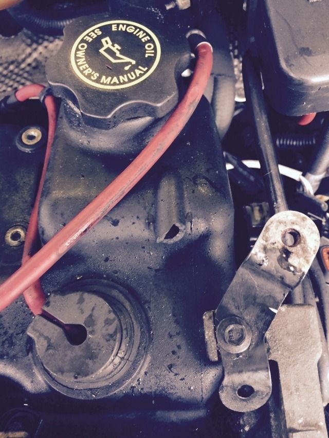

    Broken valve cover was a bit of a bummer
    But I was able to salvage the important part.

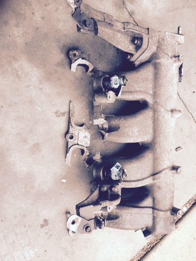

    Surprised to see the intake manifold shattered, but no big deal. My other one is ported, anyway.
    Took most of a day to do "exploratory surgery" and get the broken stuff off.
    Charged the batteries (yes, it has two little ones) overnight, and this morning, LIFE!
    Enabled me to get the hatch open. Then I removed the catch so it wouldn't latch again.

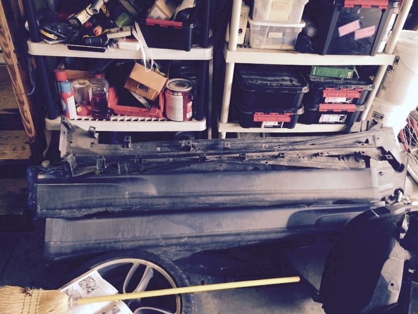

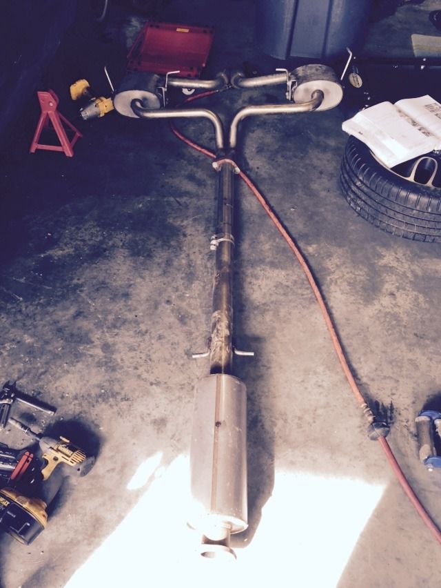

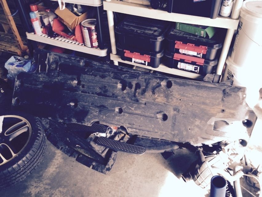

    Pulled exhaust (a nice Milltek, already sold), brake calipers, underbody panels, GP side skirts, lots of trim, heat shields...
    I'll be re-using much of this stuff.

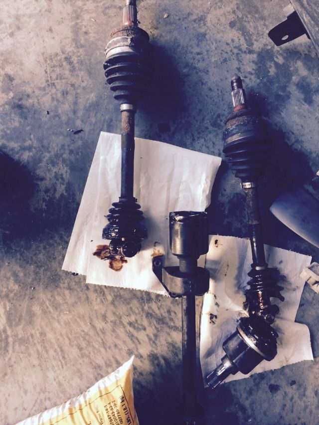

    Axles have seen better days, but I think I can recondition them.

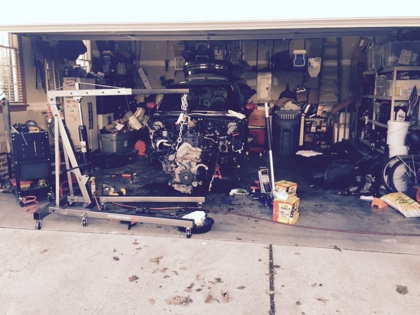

    Finished removing engine. Easier after doing Blimey's previously.
    Started pulling out the dash, removed the shifter and cables.
    Only things I have left to do on this car before I can do the transplant, are remove pedals, clutch lines, key cylinder and other needed computer modules. Lots of prep work to do on the engine next weekend before it's ready to implant in the roadster. Needs a lot of cleanup, and installation of several things over from Blimey's current engine to replace broken and inferior parts.
    This looks like someone has a serious condition. But foreshadows things yet to come.

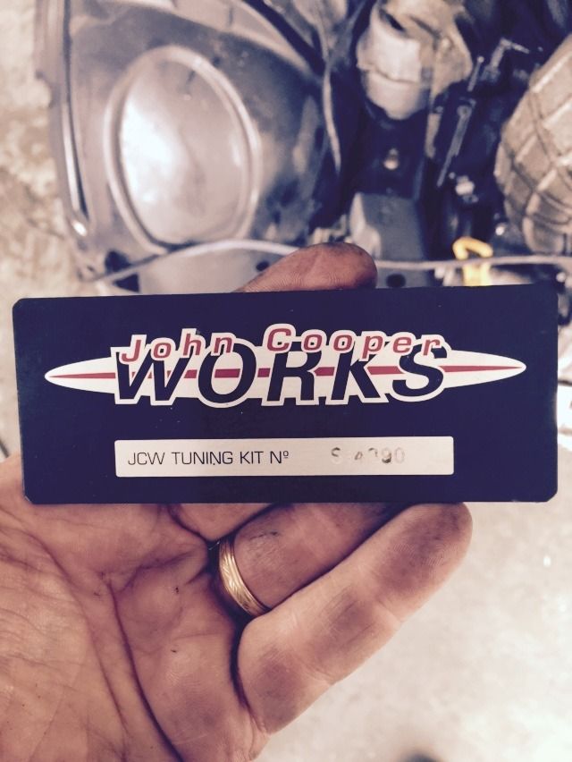

    First sacred piece of GP0769 transplanted on a new chassis. There will be many more.
