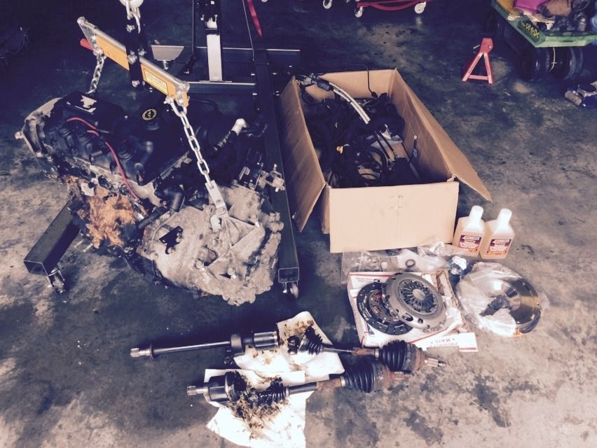

    So I think everything is off the GP that I need right now.

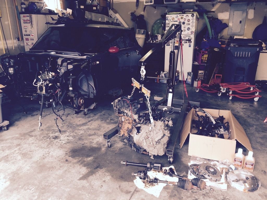

    Got the garage cleaned up and shoved the GP carcass into the back corner, to make room for the cabrio. Got all my parts organized. Everything that I need is either on the engine, or in a big box. Everything that can wait til later got shoved in or on the carcass before I rolled it out of the way.
    All the donor parts, and some new parts. The rest of the new parts are coming in the next several days.
    I thought I was going to rebuild these axles, but just discovered that one of the tripod bearing assemblies is toast. Ordered a pair of remanufactured axles instead, will return the boot kits I bought for this set.
  11. BlimeyCabrio
    Joked with the wife that I could probably fit three MINIs in this garage, on dollies like this.
    She was not amused.

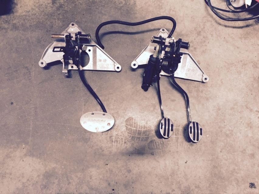

    Spent most of the day unraveling eight years worth of electrical mods. Lots is stuff I don't need anymore was inhabiting the space under my dash, my cowls, my engine bay, my bonnet, and anywhere else I could shove something...
    Much better now. Did manage to finish getting the EWS unit swapped, and got the pedals out while I was under there.

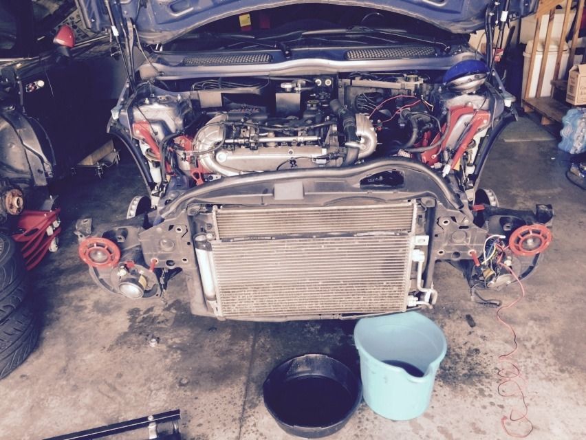

    It's mostly about this, really.
    Finally got Blimey jacked up and started tearing into the front end. Shed the bumper and wheel wells, intake, IC, and most of the engine harness. Unbolted header and drained coolant. Should be able to get the engine out tomorrow.
