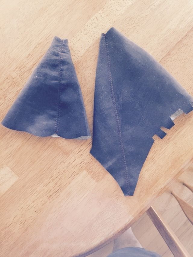

    Some treasures came today:
    Black microsuede boots w/dark red stitching, to match my seats.

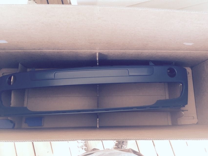

    Not going to use the bumper cover for a while... but I have it when I'm ready for it.
  9. cct1
    Make sure the lower splitter is in the box. Mine wasn't, had to make a call to get it. Wasn't from ECS though.
  10. BlimeyCabrio
    That part is sold separately. But I can reuse that and the grille off the GP. Just need the cover.
  11. cct1
    I ordered them both together, they only sent the bumper, but told me it was all in the same box.
    Anyway, if the GP bumper fascia is in good shape it doesn't matter.
    When I put the GP bumper on, I had to do some creative fastening on the lower part because of my splitter; once you've put in brake ducts and an aftermarket splitter some attachment points don't work.

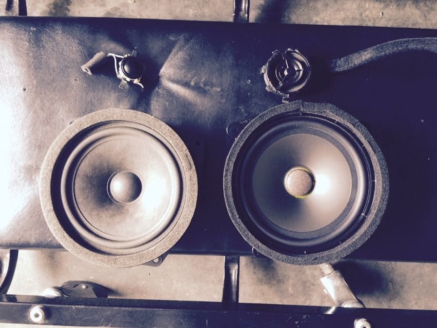

    Working on swapping door speakers (moving my HK speakers into the GP doors, now on Blimey). Discovered that the HK door harness is different than the stock audio harness. Not trivial to R&R the harnesses, but must be done. Might as well swap mirror bodies while I'm at it (Blimey's are heated).

    I haz HK agin
    Crappy stock speakers on left, HK on right.
    Doesn't look like HK, but is.

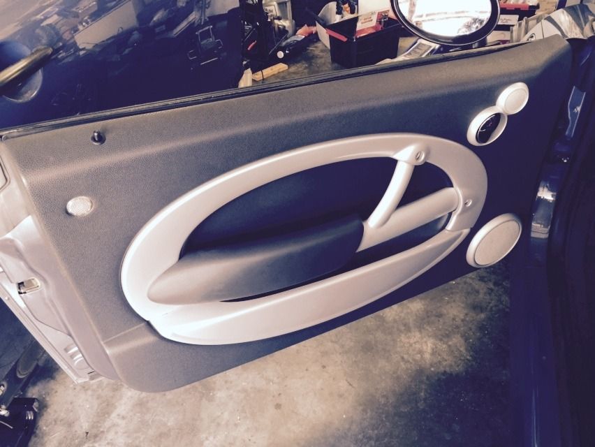

    I like the look of the stock speaker trim, actually. I think it's more attractive than the HK on my old door panels. And now you know, it fits over the HK door speakers.
    Also swapped out the mirror bodies, to get my heated mirrors back. With the red caps.
    Sounds soooooooo much better now.
