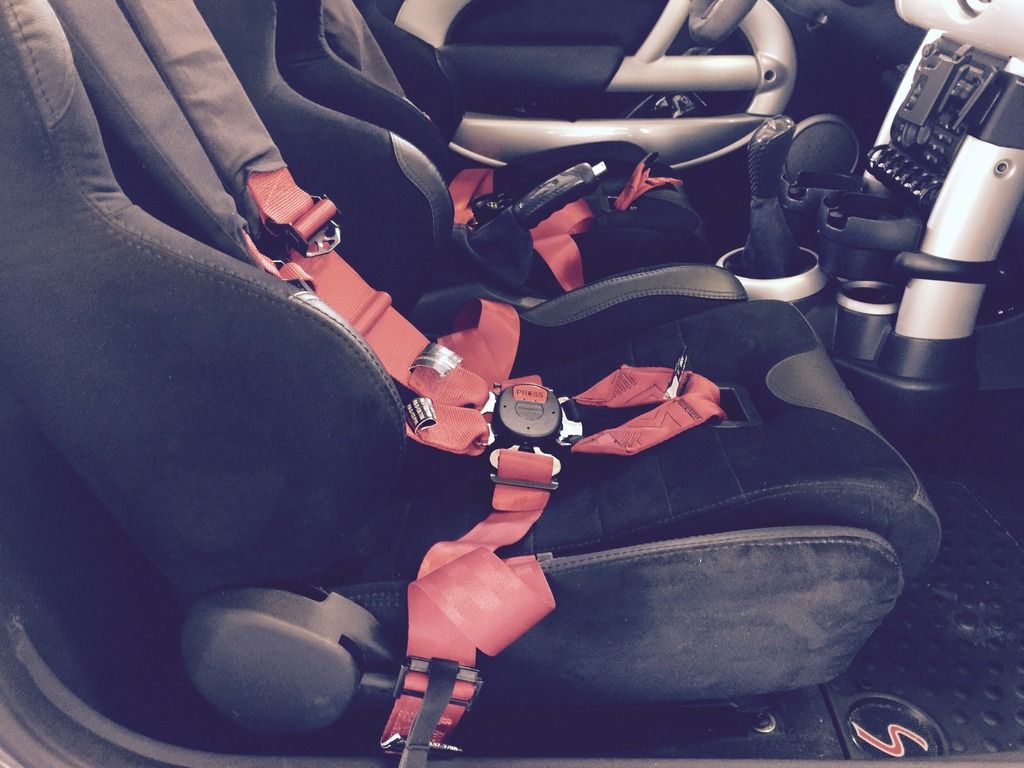

    At MOTD, Colin rode along with me for a day. He commented that the seating position with my Corbeau seats was a bit "flatter" than he would like. I hadn't really thought about it before then, but as soon as I heard it, I knew that was correct... they really did need a little more tilt to the lower cushion.
    So I pulled the seats and added about 7-8mm of spacer between the seat base and the slider rail, on the front bolts. Didn't impact the function of the sliders or the integrity of the seat, just pitched the seat back a bit. And OMG I can't believe the difference. Wish I had done this before I drove 2000 miles last week. :eek:
    In this pic, the passenger seat is "done", driver is yet to be done. Subtle in the pic, significant in person. Both took less than an hour.

    Seats are the last thing I need to do--nice tip, I'll file that one away for future reference.:Thumbsup:
  5. Dave.0
    Yeah that tilt for the bottom is everything epically on long drives.
    When I put in my recaros I noticed the same thing on the first test drive. I put 1 inch spacers and that gave me the perfect pitch for me.
