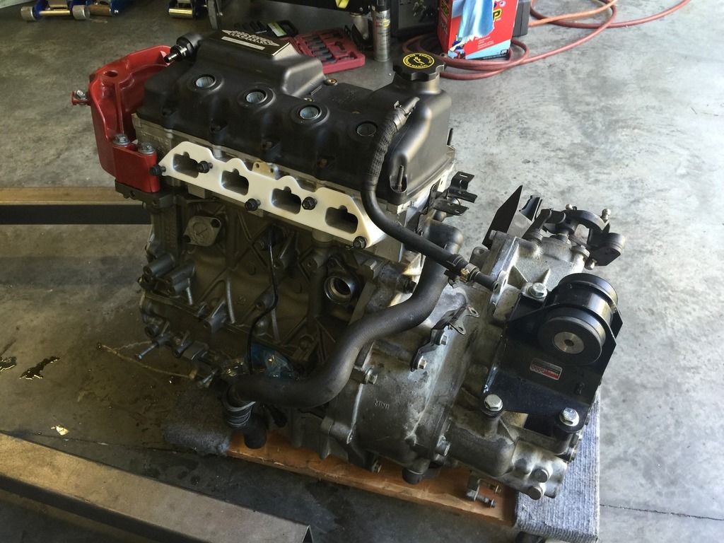

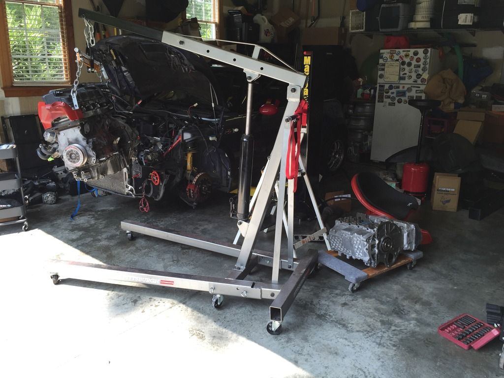

    More progress. Apparently, when you do something a lot, you get better at it. I'm getting good at pulling MINI engines.
    Engine disconnected, key parts removed, ready to pull...
    Hook up the crane and lift...
    Bay is ready for some stroking'...
    Old and new together... ready for the parts swap....

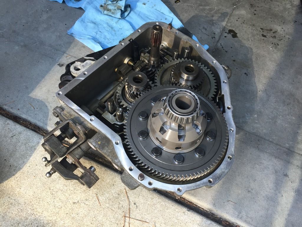

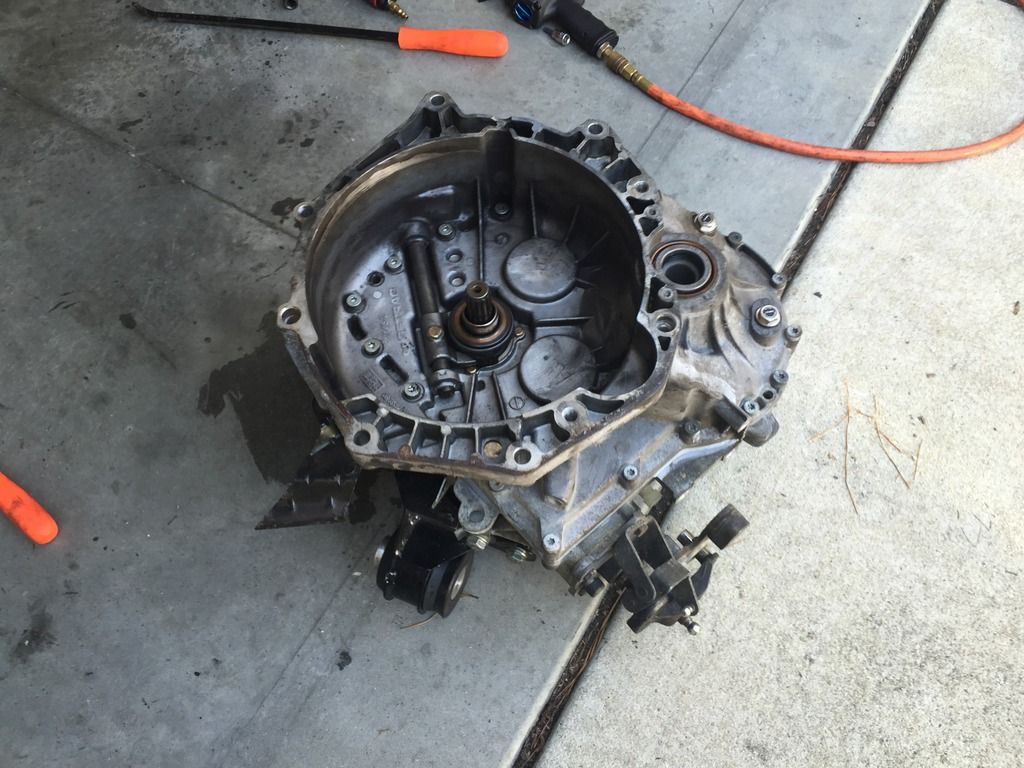

    Pulled the transmission and cracked open the case. Actually looked nice and clean for a 76k mile tranny... that's good.
    6008F5BF-51F3-4275-94D4-78B5DAE3A393_zps54mrwe3h.jpg E2743022-6B1A-47EB-B058-843795B393D5_zps1p8djdyd.jpg
    There was a nice collection of metallic goo on the magnet inside...
    That's better...

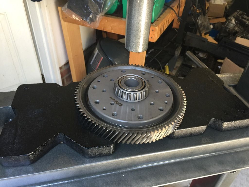

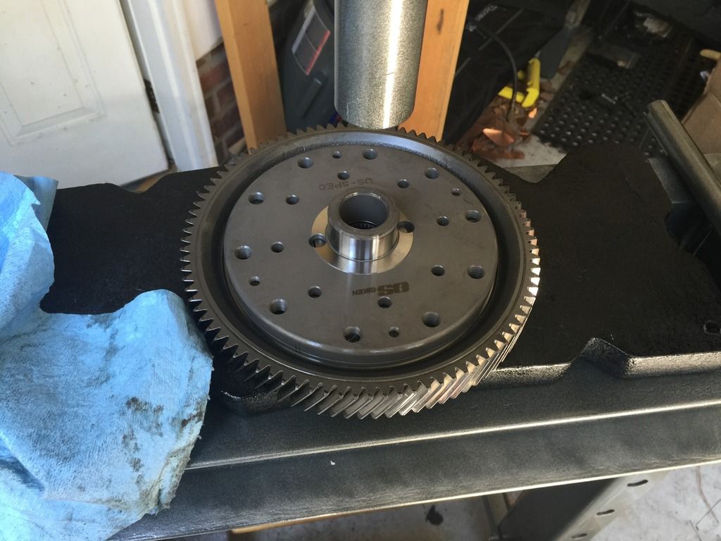

    Pressed the ring gear off the factory LSD...
    4034F94A-FDD0-43E5-9639-2A99E476F592_zpsnebpbheg.jpg 9B05B057-F477-4C2B-953D-826C9246452C_zpsucnlcw0d.jpg

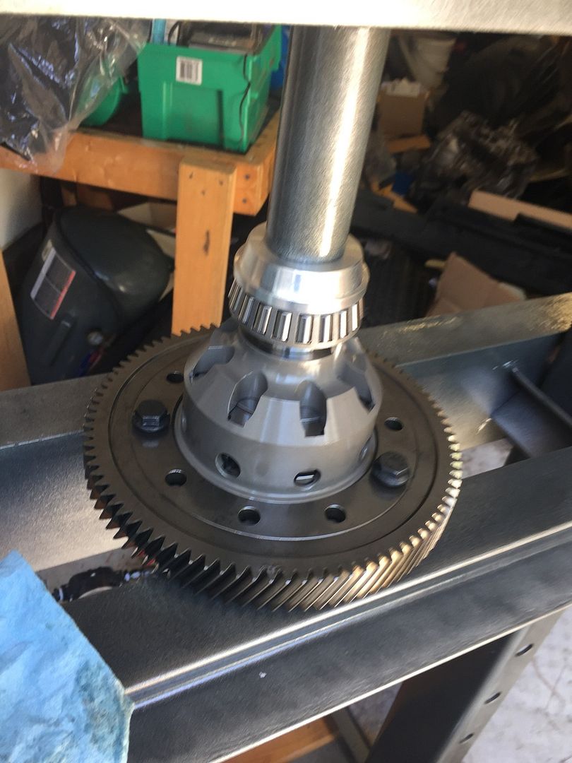

    And pressed it onto the new OS Giken LSD...
    Pressed on a new pair of bearings...
    Where it belongs. Bolts torqued with red loctite.
    Case sealed and reassembled...

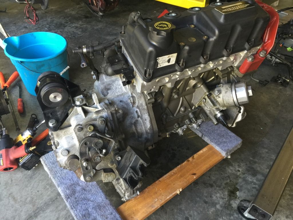

    Swapped clutch onto the new motor, and fitted the transmission. Started swapping over brackets, sensors, oil filter housing, intake manifold studs, thermostat and stuff. Almost there...
    About an hour tomorrow to finish up installing starter, hoses and engine harness... and it will be ready to hang! But I'm going to detour to installing meth system and gauge/datalogger system first, while the engine is out.

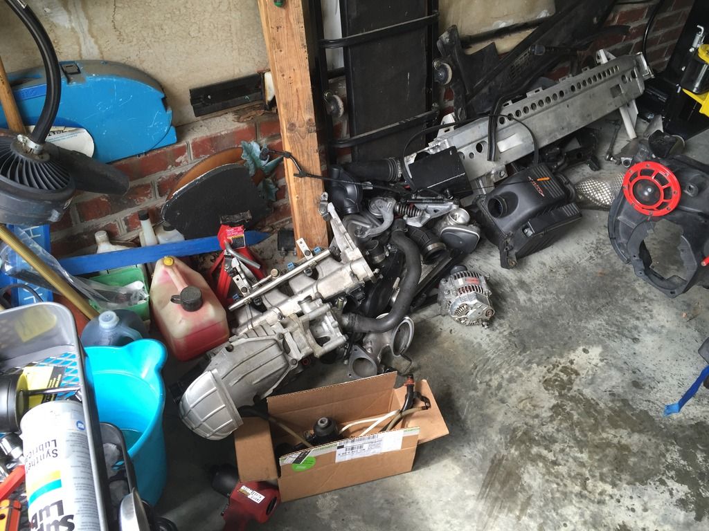

  11. BlimeyCabrio
    Farewell old friend... you have served me well for 160k miles. But time to move on.
    55C98F44-898D-4134-BD32-67A7407100A3_zpsyr0ukxk3.jpg 83D2366C-521A-42B3-BEDB-DA36F682ACEC_zpslnuikoc1.jpg EC7A2845-21E3-46B3-A257-DB2785846D26_zpsh6lyjgau.jpg

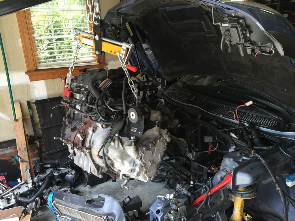

  13. BlimeyCabrio

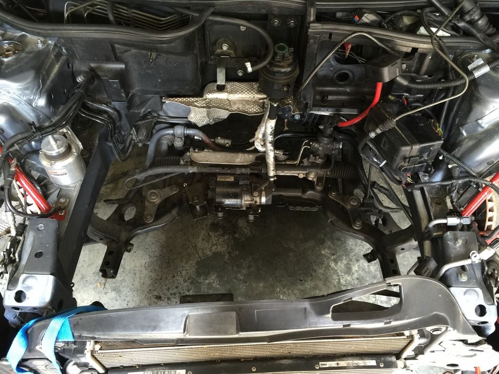

    So some expert who shall remain nameless (Colin) said "Why would you put all the stuff on it first. What a pain that would be going back in."
    It took me 10 MINUTES to hang the engine, with all the stuff on it, solo. SRSLY.
    It was an experiment, really. I've always done it the "conventional" way, taking lots of stuff off first to take it out, and putting all that stuff (intake, supercharger, throttle body, etc) back on after the engine was in place. But I really didn't think it would be an issue hanging the engine with it on there. And it wasn't, I just had to use a different hanging point to balance it.
    Also installed the 1 billion horsepower RMW axles.
    Had to fight the passenger side axle bracket snap ring for about an hour. Geesh. But it's done.
    Have I mentioned lately how much I love having a lift?
