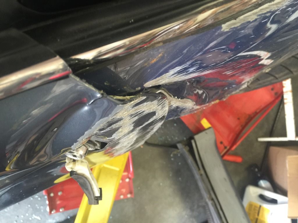

    First, took an opportunity to look at my left GP skirt which got removed WITH MALICE by the ditch. Sadly, it sheared off EVERY SINGLE MOUNT in the painted part of the skirt, and also ground it up pretty well. Also cracked up the GP sill plate.
    I'm gonna see if I can get replacements; I DO own a GP, after all. If not, I'll fabricate replacement mounts and epoxy them in, and fix the other problems.

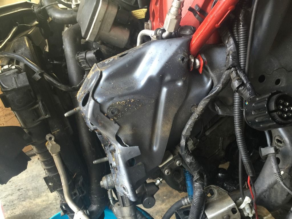

    Once I got the covers off, I saw this. What's wrong with this picture?
    Uh, the intercooler really shouldn't sit at an angle like that...
    Right intercooler mount bent, and intercooler pushed back a bit, but otherwise OK. But the horn between the IC and the intake manifold is broken.
    Oh well, I have a spare. And that will go away with the RMW front mount and custom manifold, anyway.

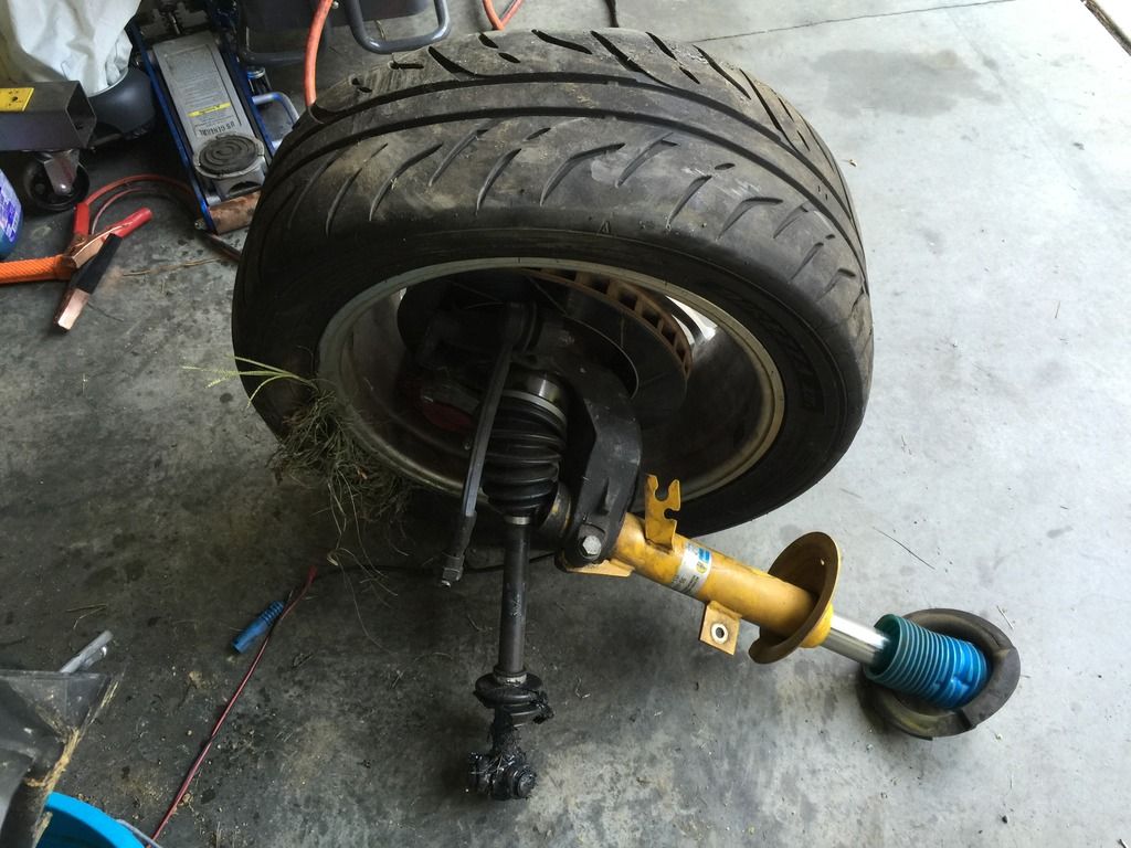

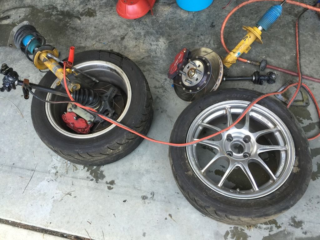

    Worked for a couple of hours to get the front wheels and suspension wreckage off. This was the part I was dreading the most, because it was a mess and the wheels were really jammed in there. Took a lot of doing, but finally got one free.
    Repeated the process on the other side, then had some fun on LXM...

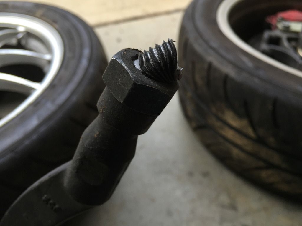

    This tie rod met physics... and physics won.

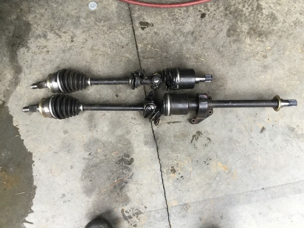

    The sense of urgency for this, is I need to send my RMW axles back for a rebuild. They're rated for 500HP... but not for vertical or inverted flight, or for deep ditch trailblazing. Still, with some cleaning, reassembly and maybe new tripod bearings, they'll be good as new.

    I'm looking at this, and two things I always thought could be "beefier" in our cars that I haven't seen a good aftermarket solution to is the tie rod assembly, and the outer ball joints...
    And front control arms, forgot that one. The oem ones are plenty strong but some decent lighter ones would be great (and if anyone suggests ALTA I'll send DaveO. your way, don't want anything that almost killed the tuner building my car).
  14. BlimeyCabrio
    Definitely I'd like to see some good, strong, light, tubular control arms.
    But I've never seen the OEM ball joint fail catastrophically, maybe others have. This is the first tie rod I've seen broken (in person). But nothing is designed to drive down ditches like this...

    The tie rods look delicate for what we're doing to these cars IMHO. The ball joints it's not so much about catastrophic failure, I'm just tired of the boots wearing out and needing to replace them. Just wish there was a more durable alternative.
