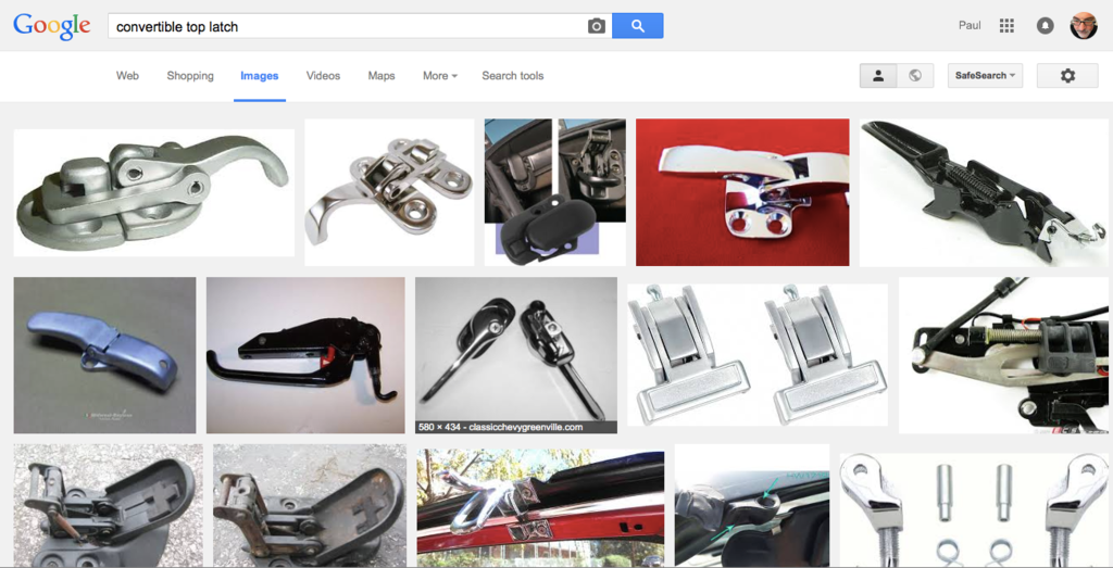

    * spends hours sifting through Google image search results for "convertible top latch"
