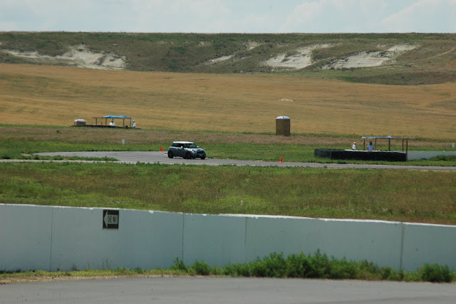

    This is turn 8, I'm holding a pretty good line in this picture. Up hill to 8 it is about 70-80-90mph then aggressive braking. The XP10/XP8 combo works well.
