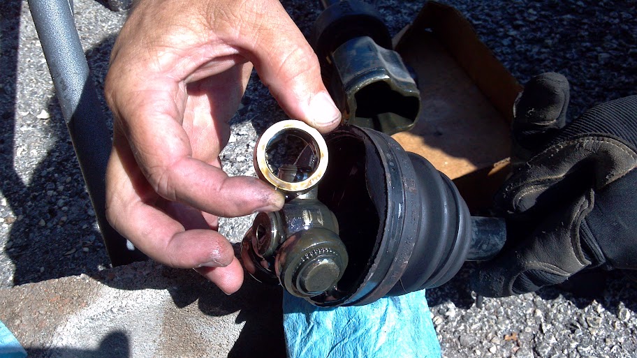

    New Passenger Side Half Shaft. I think the original had been degraded for some time. Car is smooth at any speed now. Not even a hint of vibration.
    Take that CV joint!
