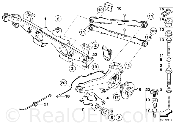

    On the front end of the rear trailing arm is a pivot bracket that attaches to the body with some fasteners.... They can be loosened (oblong holes).... The bracket can then be moved to adjust the rear toe.... Then retighten the same fasteners after the toe is set....
    The bracket is #7

    I know with some setups, you have to modify the toe adjustment bracket - grind out slots longer, etc.

    If you cannot get enough adjustment at the trailing arms, you might need to get a set of top adjustable control arms to help adjust the toe with the large negative camber.
