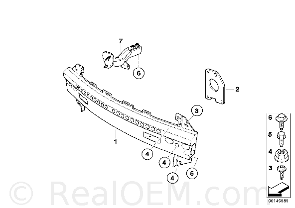

    you appear to either be missing or have taken off the alum piece that runs just behind the cover to protect the radiator and other stuff and what part of the cover actually screws too.
    The toe hook screws into it....

    Yes.... that would be P/N 51117062866
    Item #1 in the drawing...

    They didn't replace the bumper carrier! I'd be leary of other "repairs" they did...

    No doubt.. Without it there is not much supporting the cover.. The next fender bender is pushing it and the radiator right into the engine real quick..
