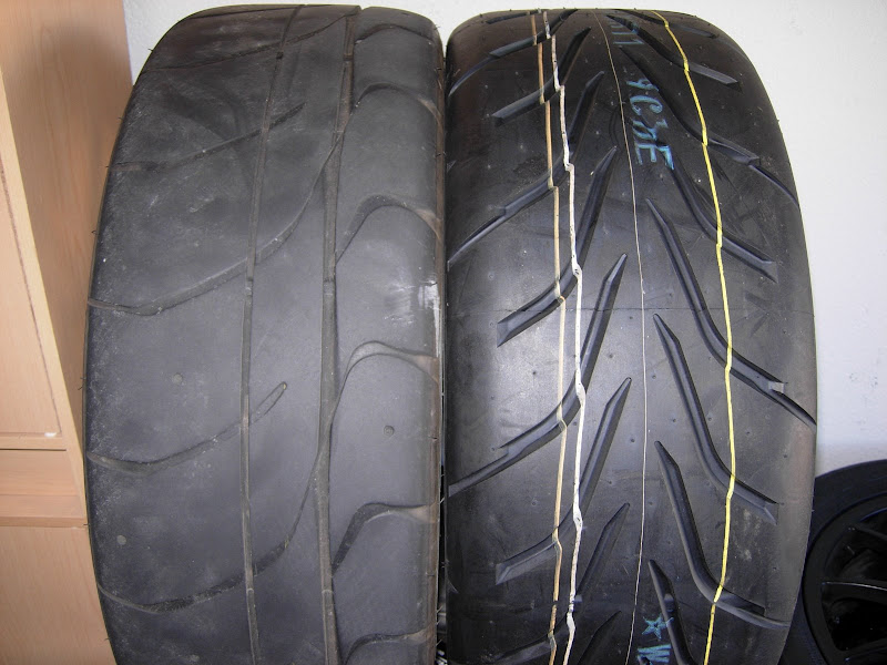

    I've had two sets of A048's.....205/50/15 shaved and 225/45/16 full depth. If they weren't so damned expensive, I'd run them as street tires. They do very well in that respect and grip very well at autox
    205/50/15:
    225's on SSR's (next to 205/45/17 RE01R's on RV-F)
    225/45-17's NT-01 left, R888 Right, both mounted on 17x7 wheel
