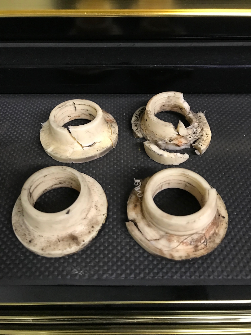

    One other completed item...I kept hearing a thunking noise when shifting gears that sounded like failed engine mounts. An inspection revealed that the engine mounts were still in decent shape.
    Next suspect was the front subframe mounts as I'd read that bad bushings on the tower mounts sometimes made that same clunking. So I loosened the front teardrop mounts, removed the two toe board mounts and the tower bolts, then lowered the rear of the subframe about 2", just enough clearance to remove the bushings above the front cones. Here is what I pulled out:
    It's a good bet I found the root cause. I went ahead and replaced the toe board and teardrop mounts too while I was at it.

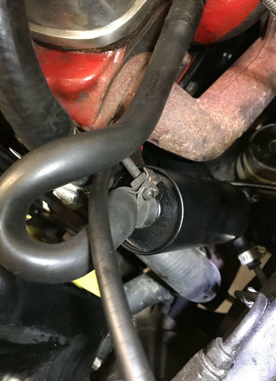

    New tappet chest oil breather for the '77. :Thumbsup:
    Took over an hour to get both the gasket and the bolt into the block lined up, not much room to work. Glad I didn't have to resort to taking the manifold off.
    Somerford Mini in the UK offered this part for less than half the cost of what Mini Mania wanted.
