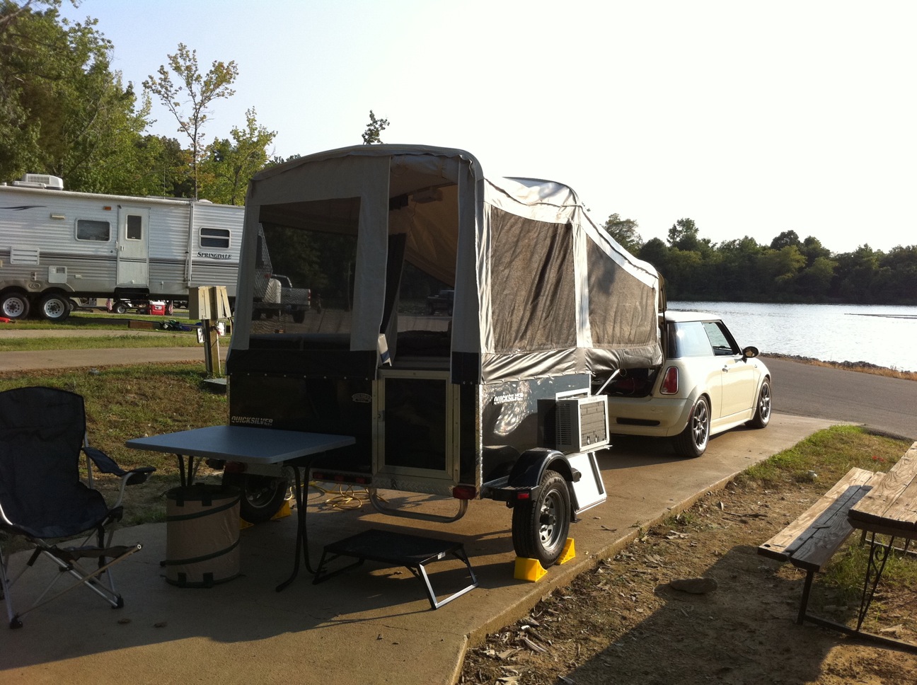

I've got the MINI Do More hitch on my '06 MCS. Putting the draw bar pin in place is a bit of a PITA (especially hard to do after a track session when the exhaust is screaming hot), but I like the completely hidden look when I remove the bar and put the fog light back in place. My trailer is around 550lbs when dry... probaby up to 800lbs if I really cram it full of gear. I pulled it a few times from Dallas to MOTD (about 1000 highway miles each way) and haven't had a problem. I've got upgraded brakes (Wilwoods up front and agressive street pads all the way around) and a pulley. Honestly, I don't even notice it back there most of the time. I know several people who purchased a cheap Harbor Freight trailer and modded it to carry wheels and tools to and from the track. If I went that often, I'd probably do the same, but I frequently like to take my trailer to the track as well, so I'll probably have to keep loading up the car with wheels and tools.

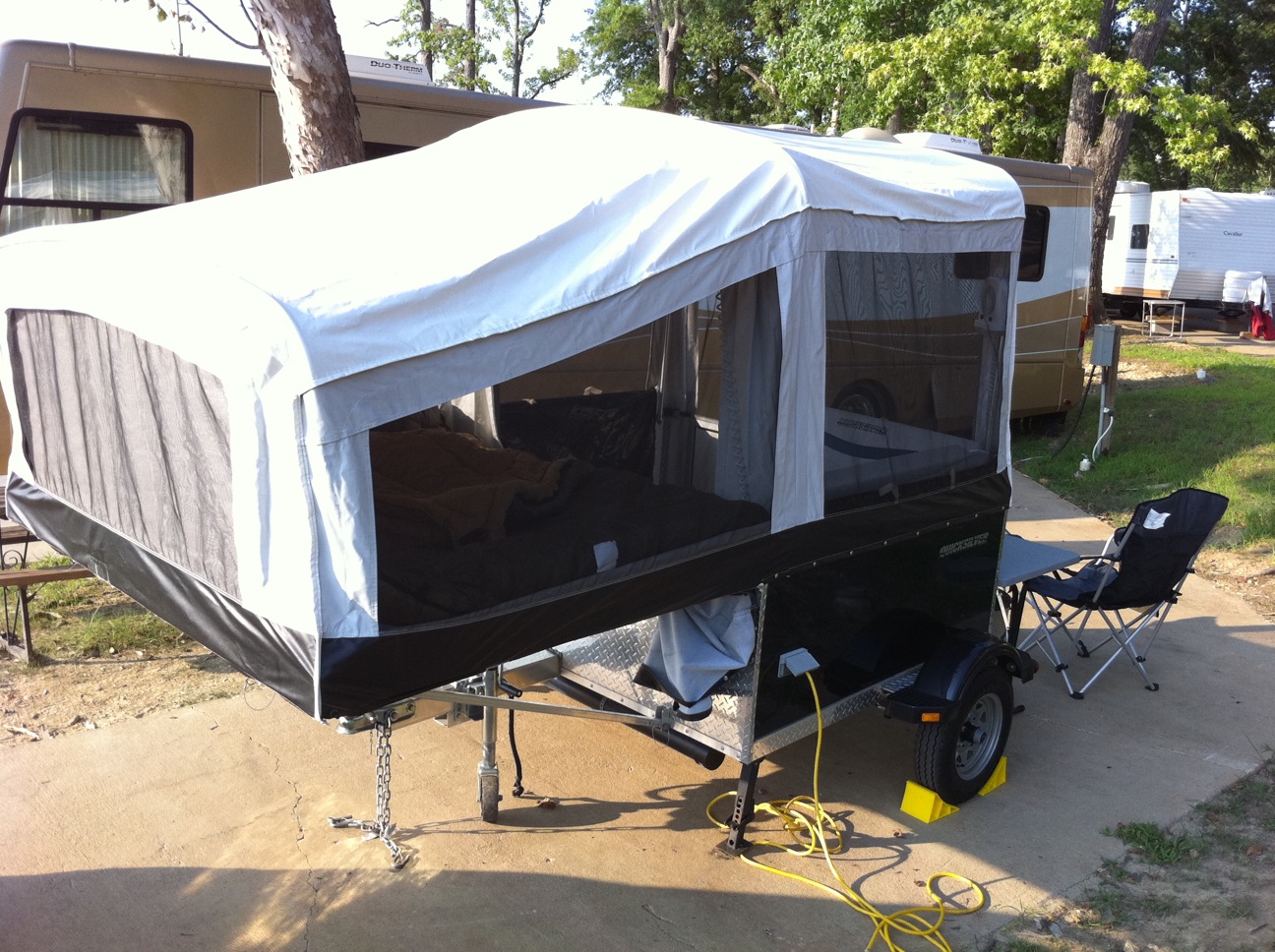

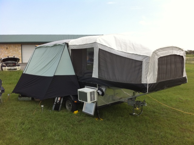

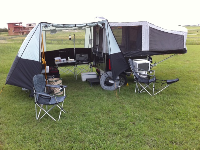

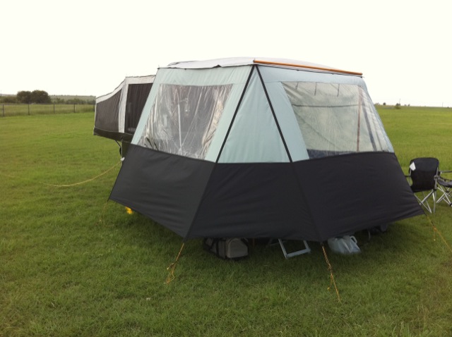

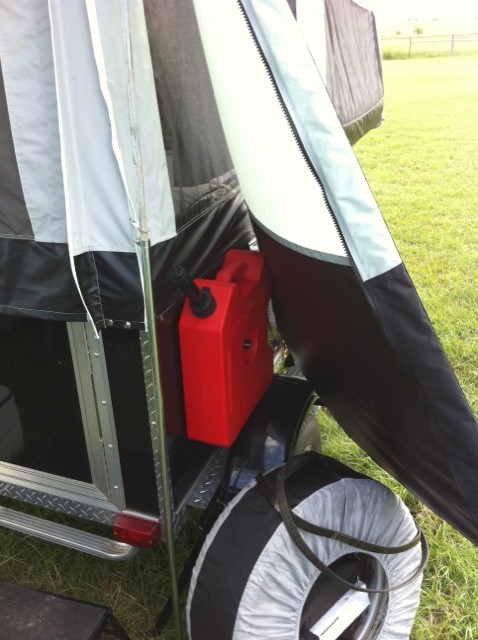

Heh... yeah... I went ahead and posted all of the pics as I usually get a lot of questions about the trailer. I've had the trailer for almost 2 years now. I sewed (musta been on NAM too much) the rear blue/black tent section myself. You can see the entire progression from purchase to complete gear set-up on my local MINI club board: [ame=http://www.metroplexmini.org/forum/showthread.php?t=29401]The largest mod I've ever done! - MetroplexMINI[/ame] It's a Quicksilver 5.0 (since replaced with the 6.0 version that is simply turned 90 degrees so you can open the tent without unhitching) from LivinLite All Aluminum Ultra Light Campers, Ultralight Campers, Lightweight Campers, Ultra-Lightweight Campers. I shot some video and posted it to YouTube: [ame=http://www.youtube.com/watch?v=Bypkq1IANXc]Quicksilver 5.0 at MSRC - YouTube[/ame] You can see a little suitcase-style Yamaha generator that I carry... it provides enough power for any small electronics / lights and is very quiet (it has a built in inverter and noise processor, so it is computer-safe). It can also power the 1000 BTU AC unit that you can see sticking out the side... just enough to keep the inside at 72 degrees when it is 95 degrees outside and I'm parked in the sun. This is a blast for track weekends... My favorite track leaves their bathrooms (with a shower) open all night, so I show up on Friday evening, set up the trailer and get the car ready for the DE event. When everyone else is getting up early for the drive to the track and swapping tires, I'm making bacon and eggs and sipping my coffee. When it is all folded up, it has enough storage that I don't have to worry about packing and unpacking the trailer all of the time. I've got an empty rubbermaid tote that I use for food/clothing + I pack a cooler and put the generator in the MINI and I'm ready to go. I met a Countryman owner at MOTD 2011 (Jill, who has a beautiful black/red Countryman modded up by Detroit Tuned) who has the larger 10.0 or 12.0 version of my trailer... has 2 bunks and a kitchen setup inside. She had a bit of a problem when she loaded too much gear in the far back end of the trailer and it was providing LIFT on the hitch over bumps, but a simple re-packing fixed things for her.

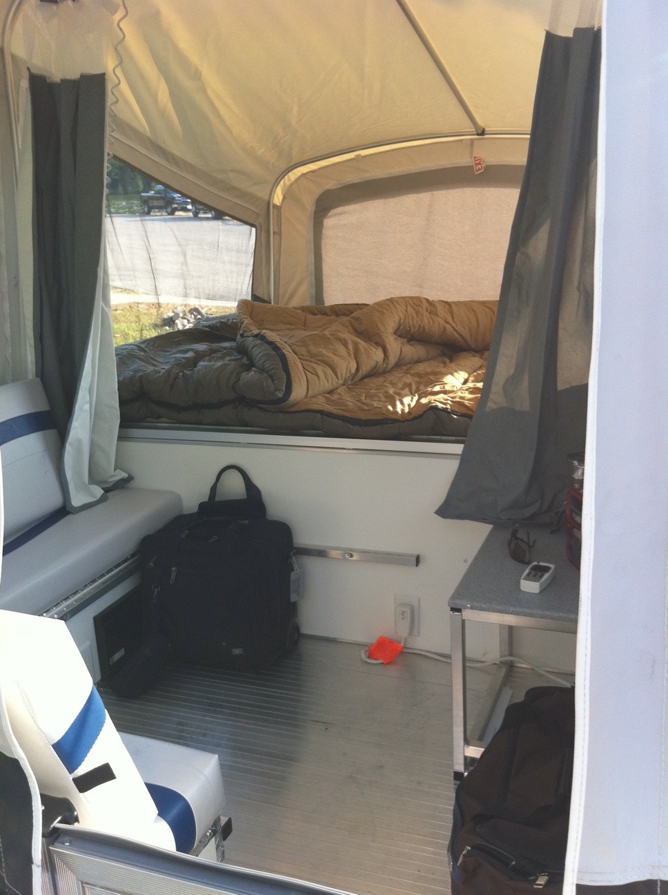

trailer ideas Wow! Those are some great pictures. Thanks for the responses. I'll check into it although I must admit the camper pics may taint my thinking somewhat. Is that camper big enough for two?
The bed is 5'x6'... basically just a smidge narrower and a smidge shorter than my queen-sized bed. That's a double-wide sleeping bag spread out on it... plenty of room for 2 + our Cairn terrier who went camping with us last year. I'm 6'4", so when I'm alone, I tend to sleep diagonally across the bed, but it works just fine for 2 people (and I'd rather sleep with my knees folded up a bit than be in a tent on the ground). The plastic top folding table that you can see w/ the water heater and basin on it is actually a part of the trailer. It is reinforced on the underside. When you fold the legs down, it can be placed on rails around the perimeter of the bench seating and the seat back cushions go down on top of it. This provides you much less standing room, but makes a 3.5'x5' (or so) bed that would work nicely for a smaller person at the same time (so Mom/Dad/Child could easily go out camping).
Pictures speak better than words... here is a manufacturer's pic of the inside in 3-person sleeping mode: My trailer has the AC option, so that little storage compartment you see in this pic is open underneath and has a door to the outside and sliders so a window-unit AC can be pulled in and out.
