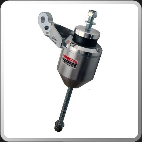

    About 2 weeks ago, I replaced my original upper and lower mounts with the VT Road. I must say the build quality was incredible. When I try to gauge vibration on both they seem to isolate very well. I also did the powerflex inserts for the transmission mount and the top rear mount. That may have been overkill as I'm getting crazy NVH at idle between 900 and 1200 RPM. Turning off A/C Helps as well as shifting into neutral.
    Now here's the question. Am I really getting any benefit from the upper inserts with the new VT mount? Will taking them out make a big difference in isolation or should I just wait longer for them to settle? Likewise, for the transmission mount inserts, I was thinking of just getting some fresh rubber stops (the little wing pieces you take out) or trying the hitemp silicone method.
    Any opinions from someone who has used the VT mounts?

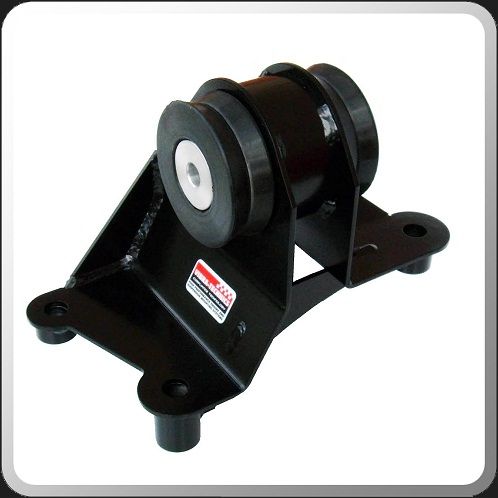

    I have the VT upper and VT lower mounts and I had no MVH. but I added the Powerflex Polly inserts and now I have MVH again. Ugh
    Looks like I will be buying the last VT mount the (Tranny mount) from Colin soon.
    My friend Mendra has installed all 3 VT mounts on his car and it is very nice now.
    You can find the tranny Mount here: Mini Cooper S R53 04 06 - Vibra-Technics Compliance Technology
    Trans mount
    Upper mount

    I would have gotten that trans mount too but I am stuck with the OEM as it is a CVT and the mount is different. Where did you do the powerflex? The transmission only or the upper rear bracket near the strut tower as well?

    The concerns of safety regarding the modified BSH lower mount are nullified after seeing what VT is comfortable with material wise for a lower mount. This is of course purely my opinion.
    The amount of material milled away from a pretty solid hunk of billet would still have a more significant amount of strength.
    The upper mount looks excellent.. hope my stock damper lasts more than 6 months, but the VT is a nice looking piece.

    When I added the Powerflex polly inserts to the OEM trans mount I got my MVH back again. :mad2:
    I will be replacing the OEM mount w/PF Polly inserts with the VT complete trans mount.
