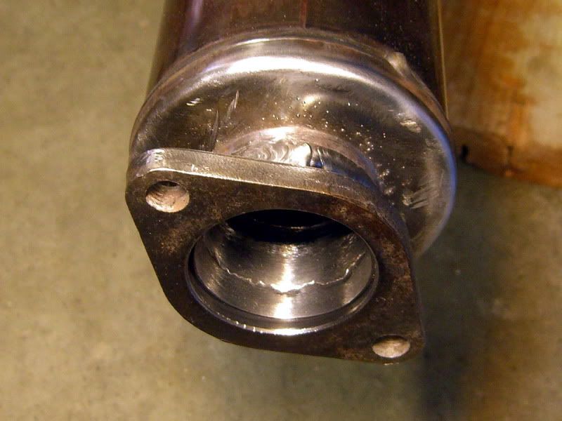

    I did have a problem with the fit to the Magnaflow cat-back. The cat-back has never fit quite right, and with the Mynes parts, the fit was just a bit too bad to live with. I blame the Magnaflow parts - the Mynes parts look great. I think it's a tolerance stack-up issue. Nothing I can't fit with a welder and a Sawsall.
    After tacking the flange on the cat-back resonator, I pulled the system out and did a proper welding job, inside and out. I also smoothed down the internal weld. This also joined the inner and outer tubing of the Magnaflow at that point, so the result should be a strong, trouble-free joint.

    I had the Magnaflow cat back on my car separate at the same place. And its mated to a stock header/cat. The local speed shop welded it closed and added a stainless strip from the flange to the resonator for more strength. The pipe between the flange and resonator is just not adequate.
